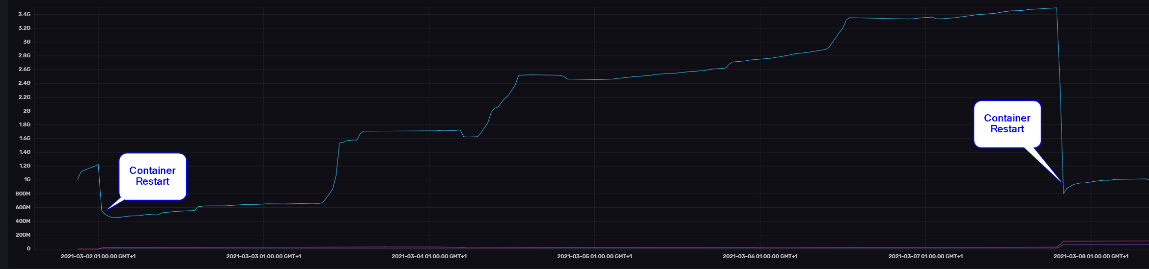

I’ve observed the memory consumption and I can confirm there is a memory leak which is probably be fixed as it was mentioned by @Andrew_Rowe
Due to the fact I don’t want to run a snapshot I’ll wait for 3.0.2 and will restart the container every few days.
Solved with 3.1.0.M3
