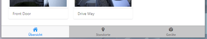

Is it somehow possible to display the location tab as default instead of the overview tab?
Also interested on how I can set the location tab as default.
Or get a direct link to this view like http://192.168.1.2:8080/location?
Me too :slight_smile:
