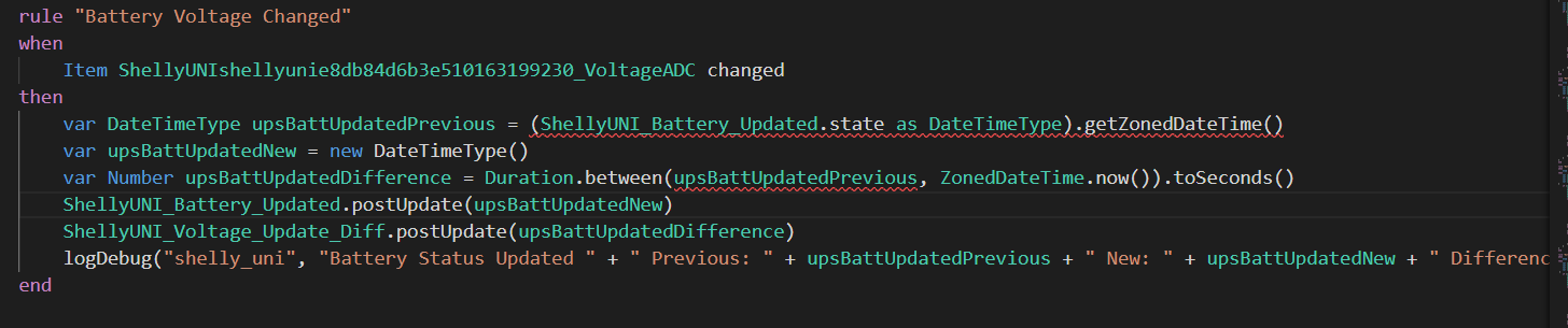

I have the following rule which is working perfectly as far as I can tell, however Visual Studio does not like it - and it was not flagged as an issue when I set it up last week?
rule "Battery Voltage Changed"
Item ShellyUNIshellyunie8db84d6b3e510163199230_VoltageADC changed
var DateTimeType upsBattUpdatedPrevious = (ShellyUNI_Battery_Updated.state as DateTimeType).getZonedDateTime()
var upsBattUpdatedNew = new DateTimeType()
var Number upsBattUpdatedDifference = Duration.between(upsBattUpdatedPrevious, ZonedDateTime.now()).toSeconds()
ShellyUNI_Battery_Updated.postUpdate(upsBattUpdatedNew)
ShellyUNI_Voltage_Update_Diff.postUpdate(upsBattUpdatedDifference)
logDebug("shelly_uni", "Battery Status Updated " + " Previous: " + upsBattUpdatedPrevious + " New: " + upsBattUpdatedNew + " Difference: " + upsBattUpdatedDifference + " seconds.")

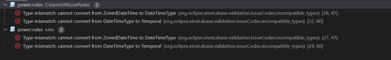

Error from VS:
and:
