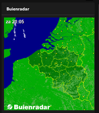

Have it working in a widget
Iframe_widget
uid: iframe_widget
tags:
props:
parameters:
- description: Title
label: title1
required: false
type: TEXT
- description: Website url
label: url1
required: false
type: TEXT
- description: Height
label: height
required: false
type: TEXT
parameterGroups:
timestamp: Feb 13, 2021, 5:10:43 AM
component: f7-card
title: =props.title1
default:
- component: oh-webframe
src: =props.url1
height: =props.height1
