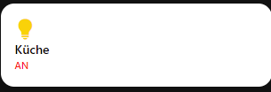

Let’s say you have a widget that contains components that should be visible/invisible depending on if there’s an item configured for this component or not.
An example would be
An “all-purpose-light-widget” that shows a slider only if also a dimmer item is being configured.
(thanks @muelli1967 for his example Building Pages in the OH3 UI: documentation draft (2/3) - #236 by muelli1967)
Light without dimmer item:
Light with dimmer item:
