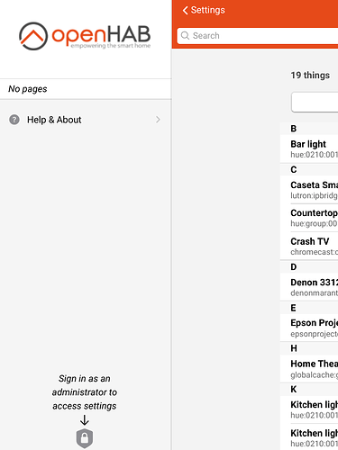

OH3 will list all your things even if you are not logged in
I wasn’t sure how to report this as an issue given the documentation links.

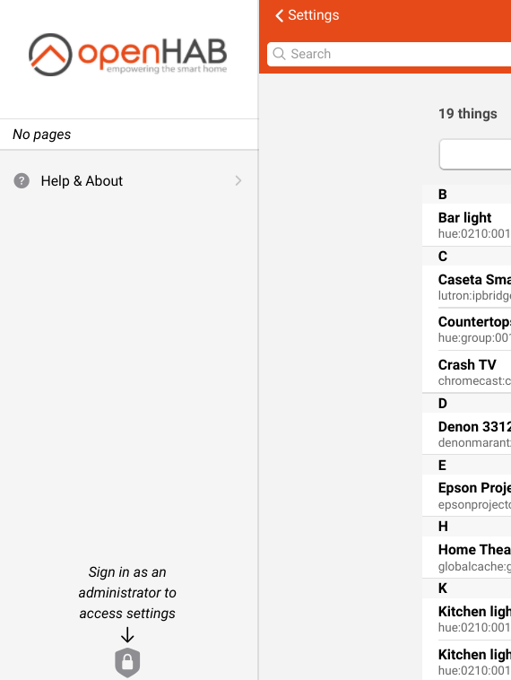

If you just type the full URL to the Things view, OH3 will list all of them even if you aren’t logged in and aren’t supposed to see settings. I haven’t tried with other views but it seems that this should be denied? In the screenshot below you can see that I am not logged in yet I can get to the Things view.
The view was accessible as http:/hostname.local/#!/settings/things/ with hostname being the hostname of my Pi.
That is a feature of the current authentication system. Currently you only need to log in to administer the system. Basic users can control devices without getting into the dangerous configuration parts.
It is an improvement over OH2 where anyone could access system management settings.
As Things may contain passwords for other services, this seems unwanted.
Passwords in thing parameters are normally hidden with **** if the binding was correctly implemented.
An issue should be opened for each binding when it is not the case.
Try this: Settings → API Security → Show advanced and disable “Implicit user role for unauthenticated requests” does it fix your issue?
This is the settings page, not a page that allows one to control things, though. It will list absolutely every Thing, along with their IDs, but you won’t control them directly from that page.
I think it’s working as designed, as mentioned by others here. But to file an issue on the MainUI you would file it on the openhab-webui repo and start the issue with “[MainUI]”.
