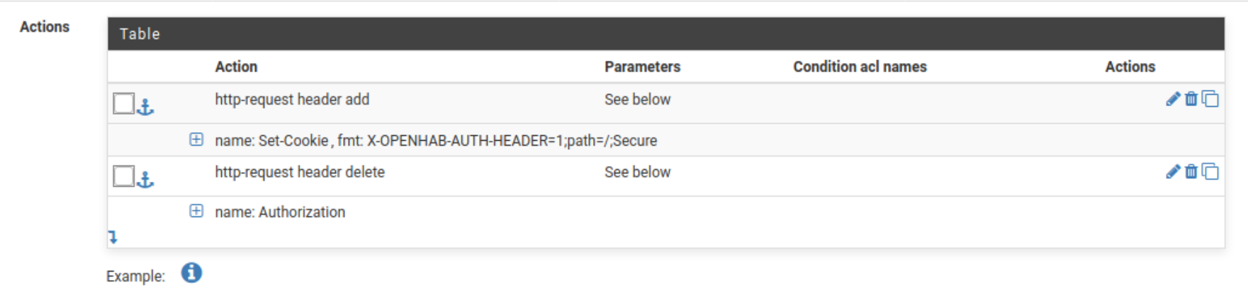

I just configured it to work in HAProxy on pfSense thanks to the information in this thread. You should be able to configure this on the front end or the back end. I configured it on the back end.
Under "Access control lists and actions click to create a new Action and choose “http-request header add”.
  • name: Set-Cookie
  • fmt: XOPENHAB-AUTH-HEADER=1;path=/;Secure
Add another new Action and choose “http-request header delete”
  • name: Authorization
I kept the authorization and authentication configuration on the front end. I also have basic auth turned off in openHAB’s settings. Therefore I need to enter a username and password to bring up the openHAB page at all. Then I need to do it again to log in as an administrator to change any settings. This suites me just fine.
