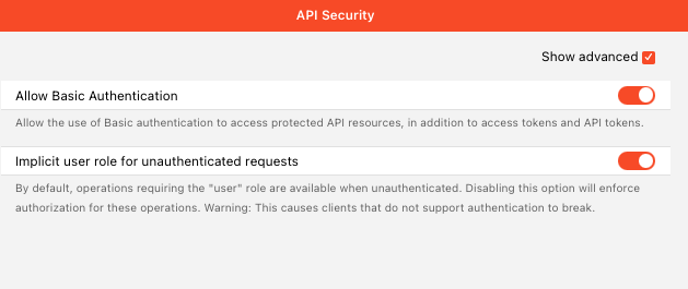

And OPENHAB 3 settings:
So if I have proxy_set_header Authorization ""; added to nginx config I can turn off “Allow Basic Authentication” in OH settings?
