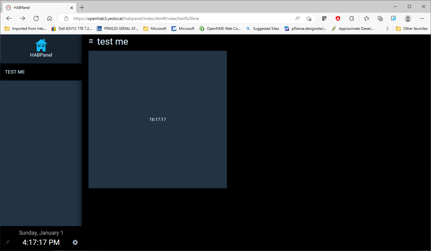

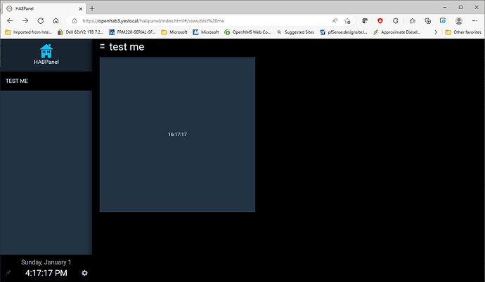

Hi Jay for what its worth I just tossed a simple openhab panel together on my test servers and I do not see the issue you mention…
as you can see from the url it is running on fqdn and secure and using IIS reverse proxy. Only difference I have here is it is server 2019 not 2012R2 (really doubt that matters) and I am running on a basic openhab build 3.4 that is running on windows10 separate machine different subnet and also vlan (again not that any of that matters either), I also tested 3.2 before on nux and as a docker and before that 3.1 and it also worked fine as I recall IIS does not care what the other environment is actually as long as it can get responses back.

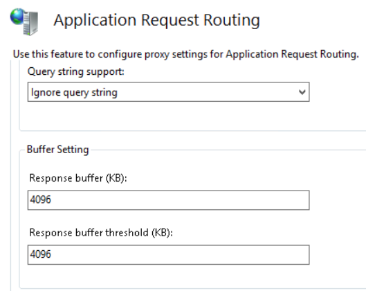

For those that are running Windows 2012, there is a default cache issue with ARR, OH 3.x reverse proxy and large list of OH items.
Thank you @justaoldman for helping me debug this situation!

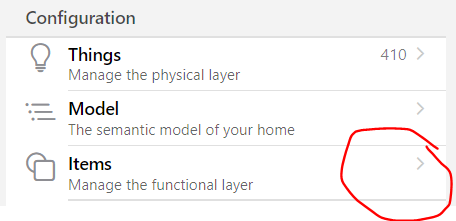

Everything worked using @justaoldman screen shot documentation, but I wasn’t seeing items in the admin portal nor was habpanel working. The issue was the Response Buffer Threshold cache setting for ARR, it wasn’t big enough so the REST call for the items was being stopped. Once you fix the items showing up in Admin, habpanel works immediately.
