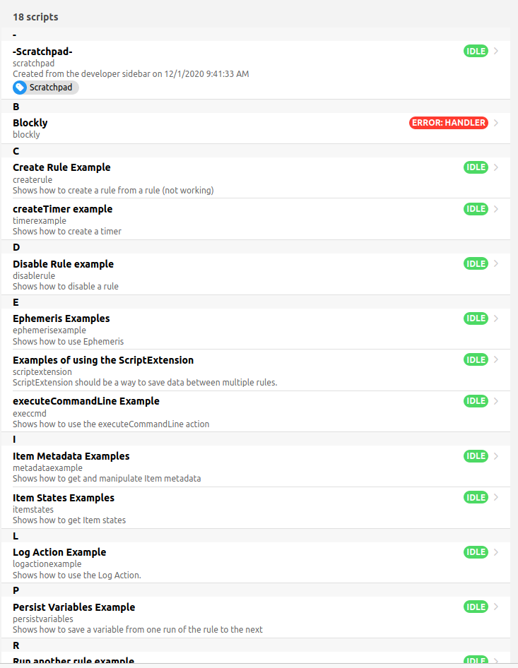

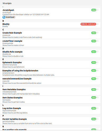

  • If I have to figure out how to do something (e.g. call a new Action, call another rule, etc) I’ll create a new Script (right under Rules in the settings in MainUI) and experiment with that until I figure out how to do it. Once I do figure it out, I keep the Script for reference and transfer that to the Rule I’m working on. From there I’ll move the code to a library (see OH 3 Examples: Writing and using JavaScript Libraries in MainUI created Rules) or just copy and paste it into a new rule when I need to do that again.

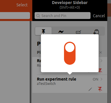

  • There are some cases where I may need to trigger the rule with an Item (e.g. I need access to event.oldState). In that case, I’ll pin the Items I care about in the Developer’s Sidebar. If it’s not a read only Item, I will be able to command the Item from there.
For other Items, I may go and add a custom default card widget to the Item (that’s what gets displayed in the Developer Sidebar) so I can command it. Or if I just need something quickly and/or I don’t want to change the default widget for this, I’ll open the Scratchpad Script (created and easily accessible from the Developer Sidebar) in another tab and sendCommands or postUpdates from the scratchpad.
