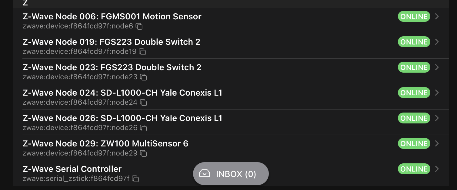

The stick was configured with Domoticz and works. There aren’t that many items on it, two FGS223 Fibaro’s, 2x Yale Conexus L1 locks, a couple of Fibaro multi-sensors, and an Aeontec Multisensor.
One lock works and one doesn’t. One of the double switches works and the other doesn’t. The double switches are successfully exposed over the HomeKit integration, but the doors don’t and the Aeontec works in OH3 but isn’t ‘responding’ in the Home App. The Fibaro sensors aren’t working in OH3.
It’s an absolute mishmash of bad bindings. It just doesn’t seem to work properly. is it hardware? Is OH just not compatible with ZWave.Me?

they might show online, but they don’t all work. I can see comms occurring in the tail log, but nothing happens on the devices; no state change, no light going on when requested. some of the devices were showing null endpoints indicating that while discovery had occurred, they were inoperable.
I think I explained the problem, some things are working and some things are not, regardless of their ‘online’ status. So the ‘bridge’ wasn’t bridging, but there isn’t any consistency as to why one thing of a certain type works and another doesn’t. Other than perhaps the first one of a type works and any subsequent additions of the same type, don’t.
