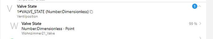

The channel, which is importet via homematic binding is defined as number:dimensionless
The item, linked to the channel is also defined as number:dimensionless and showing the correct value.

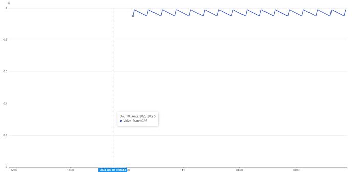

But in the logs the value is shown as 0.99 without uom
2023-08-11 11:31:43.290 [INFO ] [openhab.event.ItemStateUpdatedEvent ] - Item 'Wohnzimmer21_Valve' updated to 0.99
the items analyzer is also showing 0.99 but with uom %
The item itself and the locations tab are showing the correct value with uom.
No metadata is defined for this item.

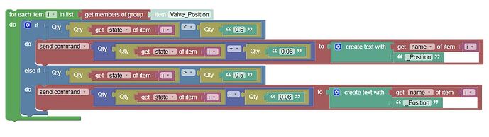

In a rule i do math with the items state, but i cant use add 6%, i have to do like this
the rule is perfectly working like this, but why i cant use “add 6%”., and why the log is showing 0,99 instead of 99%?
