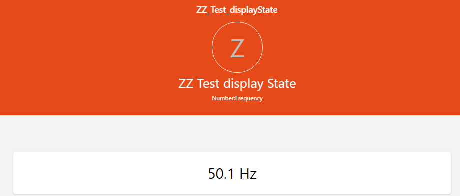

Which from my understanding and past experience should display the item with a single decimal place, as follows:

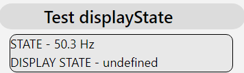

This works correctly for some values, however occasionally goes to undefined as can be seen in the following widget:

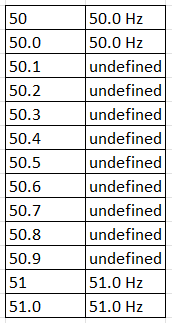

I used the API Explorer to assign values to the item, results as follows:
I can’t work out why some values are undefined, surely they should be displayed correctly with 1 decimal place?
Mark
EDIT: More detailed table

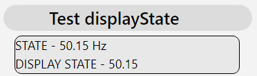

It does allow setting the Units. Doing so however does not make any difference.
the item to 50.3 Hz produces:

That said, it is strange that 50.0 produces 50.0 Hz, and only the others are an issue?
