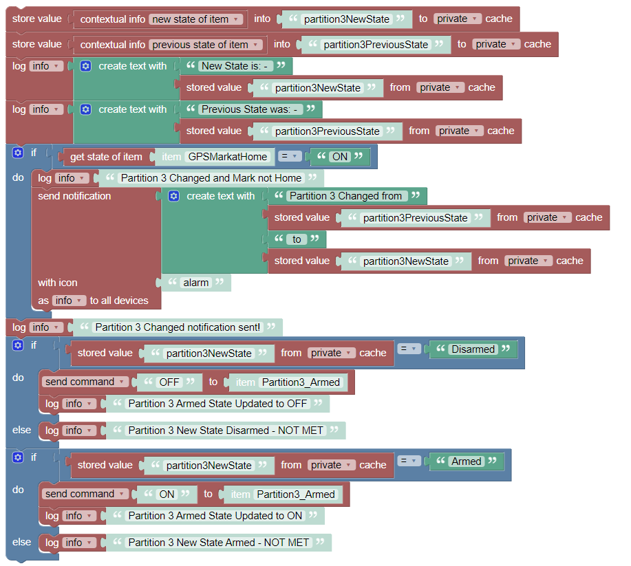

As part of my move to Blockly I have set up the following rule:
which generates:
cache.private.put('partition3NewState', event.itemState);
cache.private.put('partition3PreviousState', event.oldItemState);
console.info(('New State is: - ' + String(cache.private.get('partition3NewState'))));
console.info(('Previous State was: - ' + String(cache.private.get('partition3PreviousState'))));

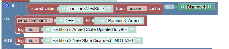

if ((cache.private.get('partition3NewState')) == 'Disarmed') {

However I cannot work out why the last two if…do blocks fail?
From the logs I see:
17:08:40.401 [INFO ] [ion.script.ui.Partition_3_StateChange] - New State is: - Disarmed
17:08:40.402 [INFO ] [ion.script.ui.Partition_3_StateChange] - Previous State was: - Armed
17:08:40.403 [INFO ] [ion.script.ui.Partition_3_StateChange] - Partition 3 Changed and Mark not Home
17:08:40.403 [INFO ] [ion.script.ui.Partition_3_StateChange] - Partition 3 Changed notification sent!
17:08:40.404 [INFO ] [ion.script.ui.Partition_3_StateChange] - Partition 3 New State Disarmed - NOT MET
17:08:40.405 [INFO ] [ion.script.ui.Partition_3_StateChange] - Partition 3 New State Armed - NOT MET
So partition3NewState is "Disarmed", so this block should be met (unless I am doing something dumb)?
Any hints would be appreciated.
Mark

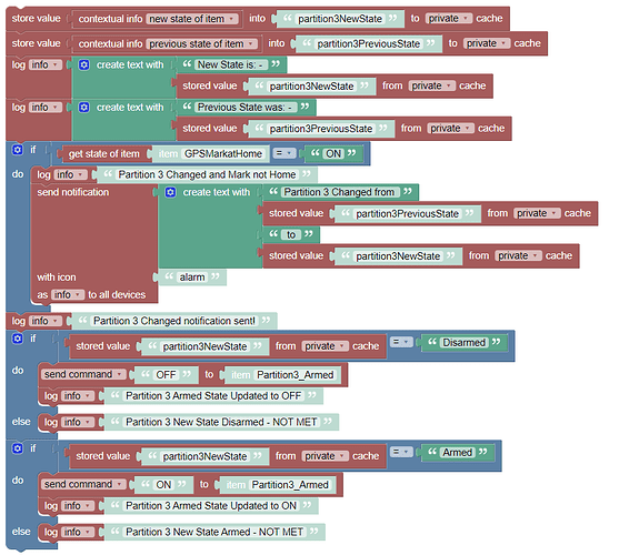

There is absolutely no reason to use the private cache in this case. No matter what was in the private cache when the rule was triggered, it gets overwritten immediately when the rule runs again. You can’t share data between rules using the private cache. Why use it at all? Just use contextual info new state of item and contextual info previous state of item and get rid of the complexities added by using the private cache.
The two if blocks fail because nether value stored in the cache is a String. They are State Objects. But you are trying to compare them to a String. By shoving these into the private cache you lose information about them which hinders it’s ability to convert the State to a String for you.
It might work by simply dropping the use of the cache here, since it is not just pointless but might be working against you. If that’s not sufficient, I think you can convert the State to a String using the to item append text block.

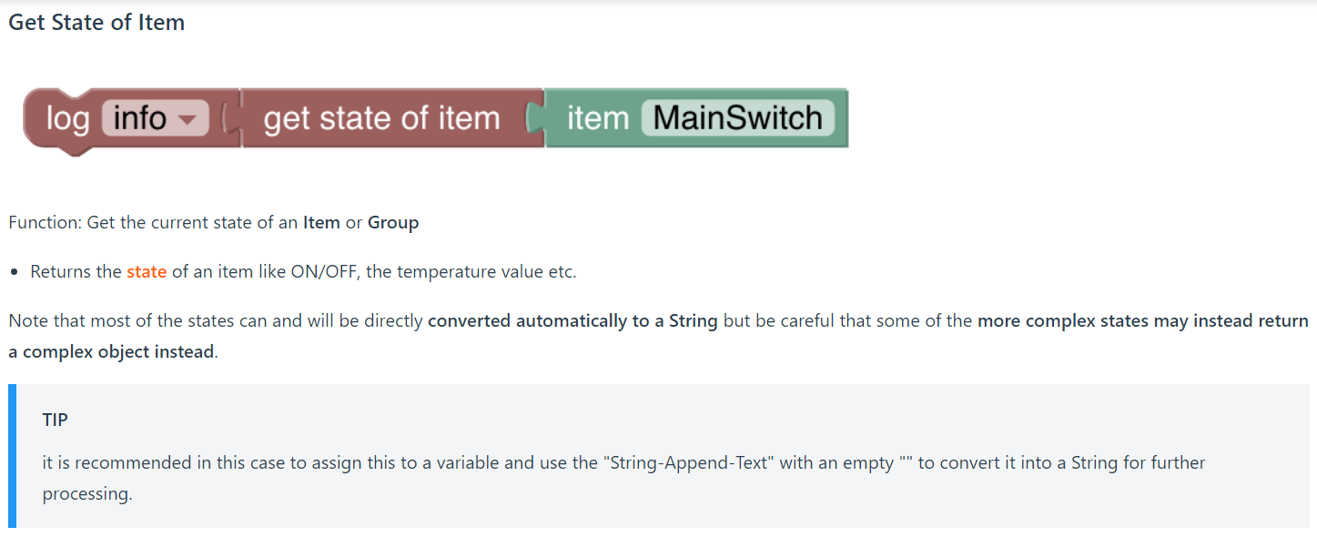

Solution was:
This did not catch my attention… But I now have it working by converting to string using the “TIP”.
