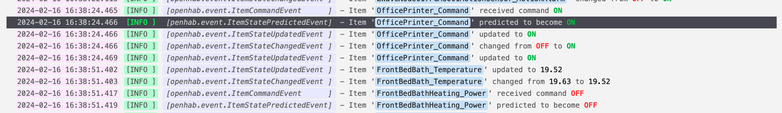

2024-02-16 16:38:24.465 [INFO ] [openhab.event.ItemCommandEvent ] - Item 'OfficePrinter_Command' received command ON
2024-02-16 16:38:24.466 [INFO ] [penhab.event.ItemStatePredictedEvent] - Item 'OfficePrinter_Command' predicted to become ON
2024-02-16 16:38:24.466 [INFO ] [openhab.event.ItemStateUpdatedEvent ] - Item 'OfficePrinter_Command' updated to ON
2024-02-16 16:38:24.466 [INFO ] [openhab.event.ItemStateChangedEvent ] - Item 'OfficePrinter_Command' changed from OFF to ON
2024-02-16 16:38:24.469 [INFO ] [openhab.event.ItemStateUpdatedEvent ] - Item 'OfficePrinter_Command' updated to ON
Note the malformation in the entry:
2024-02-16 16:38:24.466 [INFO ] [penhab.event.ItemStatePredictedEvent] - Item ‘OfficePrinter_Command’ predicted to become ON
That doesn’t look favourable. It’s appearing in all instances I’ve posted so far.
