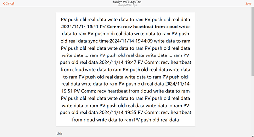

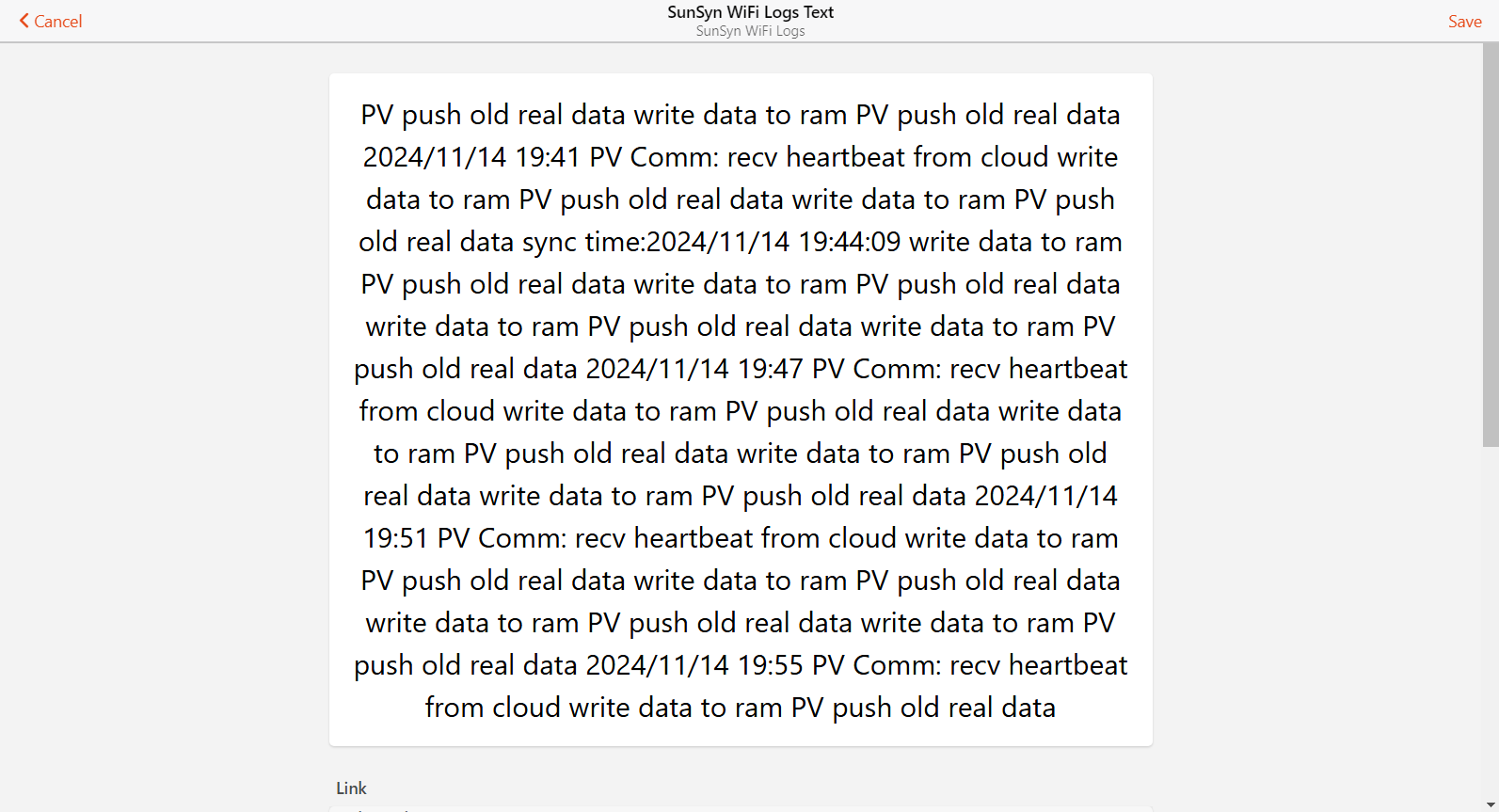

I have finally managed to get my HTTP Binding THING online and I am getting the raw data into a STRING item:
The string data can vary greatly - can be longer, shorter, contain what I am looking for or not, contain the line more than once (unlikely, but would be interested in the last occurrence):
I am trying to find a way to retrieve the single line that I am interested in and update this to an ITEM.
The line I am interested in is:
sync time:2024/11/14 19:44:09

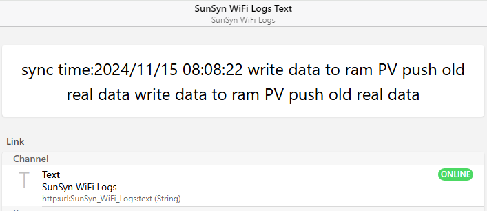

This is a quirk" of the way the web site I am scraping works.
The web site is a “rolling” log of events. It seems to work on a buffer type system where the page resets when the buffer fills up, so if the HTTP Binding polls the page at that specific time there is a chance (actually quite frequent) that there is no sync time:2024/11/14 19:44:09entry at all.
When this happens the REGEX linked item is updated with an empty string.
I am not interested in these empty strings - only what the most recent sync time value was.
So I need to ignore any empty updates and only process actual values.
Hence the rule that I showed above.
