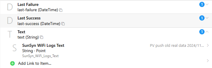

So I found my issue.
When creating the THING, the default two channels are not enough to bring the THING online.
I had to add a String Channel and then it came ONLINE
Worked out by using a demo.thing file from the docs and duplicating the config in the code tab of my UI created THING.
