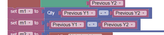

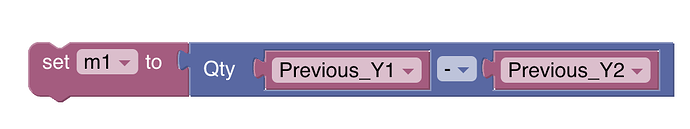

Seems to be an issue with the UoM QTY blcoks?
Produces:
m1 = (.subtract());
m1 = Previous_Y1 - Previous_Y2;
So I am pretty sure the first calculation is wrong. Could this be the root of the problems?

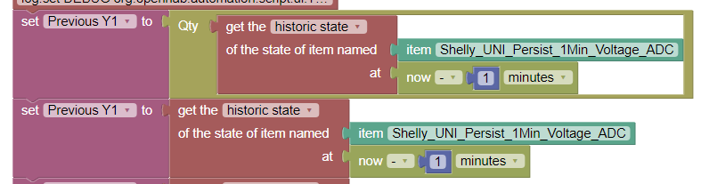

And even
Produces:
Previous_Y1 = 0;
Previous_Y1 = items.getItem('Shelly_UNI_Persist_1Min_Voltage_ADC').history.historicState(time.ZonedDateTime.now().minusMinutes(1))?.state;
And again the QTY version is incorrect.

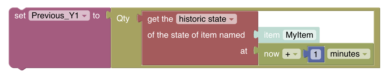

It is a pity I have only seen this thread by chance.
When you say that the UOM blocks are broken, are you referring to the variable usage?
I have provided a fix for that yesterday
because I stumbled over it myself during documenting the latest changes.
Sorry for the inconvenience.
Update: Now I saw your filed issue on github: [blockly] Latest UoM QTY blocks with variables no longer work · Issue #1907 · openhab/openhab-webui · GitHub
Unfortunately I need to check this out again.
The problem is that blockly cannot detect the type of the content of the variables which is a pity which is why I need to make assumptions, so I went for
Blockly cannot detect the type that is contained in a variable so it expects an item object.
This allows to iterate over a group of item members which returns a list of item objects
