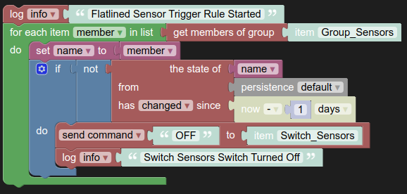

This rule has broken since switching to OH4, even after re-creating it to avoid problems with old javascript/new javascript. Can anyone tell me what the issue is?
Log:
2024-04-15 20:21:13.163 [ERROR] [b.automation.script.javascript.stack] - Failed to execute script:
org.graalvm.polyglot.PolyglotException: TypeError: undefined has no such function "changedSince"
