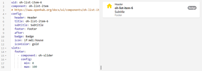

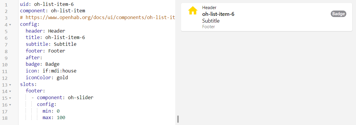

I tried to add (one, two three) oh-slider component(s) to the footer slot (that’s where the oh-slider-item has the oh-slider component). This does absolutely nothing…
Do you have any hint for me? or do I really have to recreate the full oh-list-item yaml from the .vue files first, just if I want to add something else than text to some other slot than after of existing oh-xxx components?
If you are looking through the oh-list-item vue file then you will see that the reason this doesn’t work is that the footer slot has been rendered unusable in that definition.
Part of developing the oh- widgets for more beginner friendly use has meant reducing the amount of options and complexity. So yes, as things stand now, if you want to adjust the oh-list-item by putting something in the footer slot specifically, then you will need to recreate the base item from the original f7 components. If you understand most of what you are seeing in the vue files then this isn’t actually too lengthy a process. In fact, if I recall there are already several examples around the forums where others have already done most of this for you.

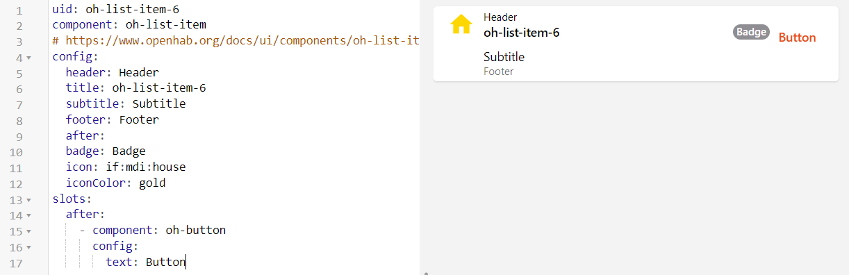

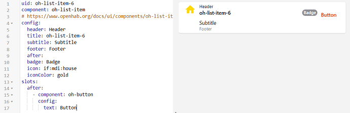

That will allow you to add additional components in those slots (in this case the after slot).
