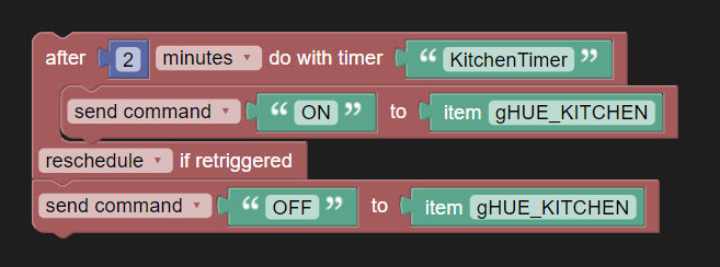

Use blockly to generate the correct code and compare.
Within blockly there is a code view, so that you can copy & paste the auto generated code into your own script, if you prefer to script it by yourself
Have never used blockly.
Is that the only way to debug ?
Edit:
So I have tried blockly
Results in this Code

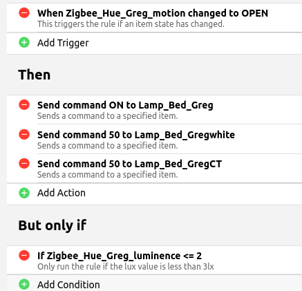

I have hue sensors and I use the UI and have a rule to turn the light on when the sensor is triggered.
The rule has but only if the lumination is less than 2.
The light I use has an expiration timer set for 2 minutes and that resets if the sensor sends again.
No code needed need. Works well.

My solution is putting an “expire” in my items definition
Group:Dimmer:AVG                gHUE_KITCHEN            "Kitchen Light(s) [%d %%]"      (gHUE_TOTAL,gKitchen)           ["Lightbulb","Light"]   { expire="30s,command=OFF" }
if (gPresence.state != ON || HUE_KITCHEN_MD_LIGHT_LVL.state > HUE_LIGHT_LVL_LIMIT_LOW || stat_QREVO_STATUS.state != "Charging")
	return;
gHUE_KITCHEN.sendCommand(ON)
logInfo("hue.rules","KITCHEN: MOTION DETECTED - LIGHTS ON; LIGHT LEVEL " +String.format("%.2f",(HUE_KITCHEN_MD_LIGHT_LVL.state as Number).floatValue))
This is my rule:
configuration: {}
triggers:
  - id: "1"
    configuration:
      itemName: Zigbee_Hue_Greg_motion
      state: OPEN
conditions:
  - inputs: {}
    description: Only run the rule if the lux value is less than 3lx
    configuration:
      itemName: Zigbee_Hue_Greg_luminence
      state: "2"
      operator: <=
    type: core.ItemStateCondition
actions:
  - inputs: {}
    configuration:
      command: ON
      itemName: Lamp_Bed_Greg
    type: core.ItemCommandAction
  - inputs: {}
    configuration:
      command: "50"
      itemName: Lamp_Bed_Gregwhite
  - inputs: {}
    configuration:
      command: "50"
      itemName: Lamp_Bed_GregCT
It looks like this:
