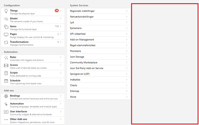

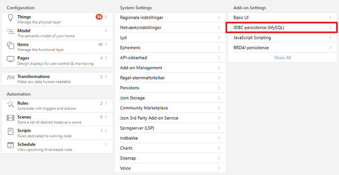

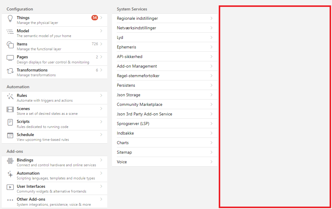

I upgraded a few days ago and checked the persistence. RRd4j and mariaDB got all changes like before. today I wanted to check for the credentials and couldn’t find the configuration on MainUI. After checking I found out, that somehow “JDBC (SQLite)” was installed and “JDBC persistence (MySQL)” was not. So I installed the latter, but still: no configuration visible in MainUI.
the MariaDB got entries since the updgrade to OH4 and still does… But I can’t access its configuration… What did I miss?
There was a change in 4.0 UI which removed all non essential service settings away in a hope that every of such configurations is related to an existing addon service: https://github.com/openhab/openhab-webui/pull/1891
