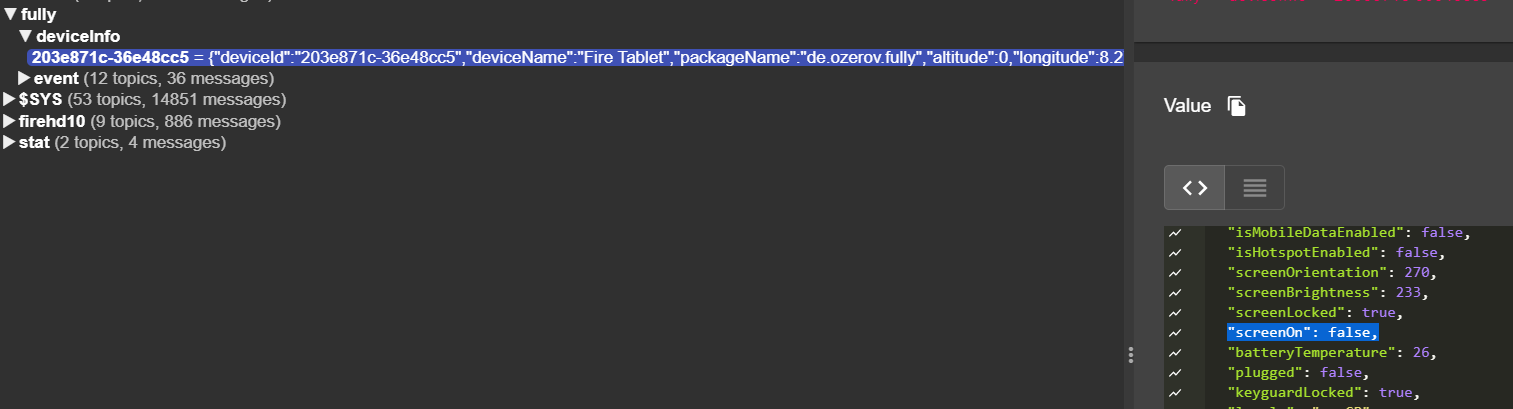

I have a FireHD10 Tablet which is running Fully Kiosk Browser.
Via MQTT it publishes various device info (which I can see with MQTT Explorer).
What I am interested in is: I want to grab the current Screen Status (ON/OFF).
Here is the current status:

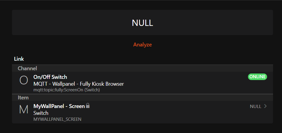

Unfortunately I have no idea how to / or
a) get the current status and
b) transform “true” = ON and “false” = OFF
c) if I have even configured my *.things correctly
Sorry for being so unprecise:
a) get the status of my FireHD10 screen. screenON = true/false (retrievable via MQTT)
b) corrected that
c) what info is missing ?
You’ve never really posted the JSON that’s being parsed. Screen shots are all but unusable most of the time. Verify that you’re suing the correct topic.
And nothing’s going to happen until you link the Channel to an Item of course.
