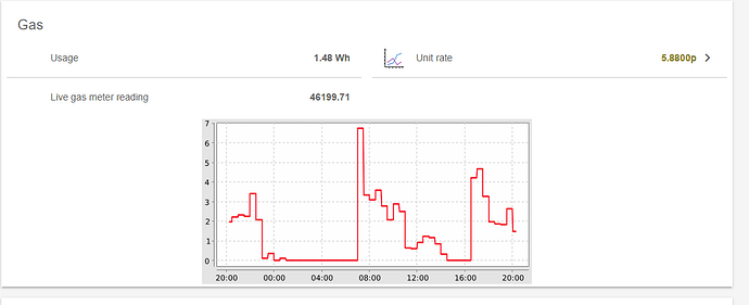

Just got it working for gas too. You’ll need to get your gas meter guid the same as the electric just changing electricityAgreements to gasAgreements.
octopus.items
Number GasMeterDemand "Gas usage (Home Mini) [%.2f kWh]"
Number GasMeterReading "Live gas meter reading [%.2f]"
octopus.rules
rule OctopusGasMeterUpdate
	Time cron "0 0/30 * * * ? *"  // run evry half hour
    logWarn ("rules.OctopusMeterTelemetryGas" , "Get realtime octopus smart meter gas data")
    var url = "https://api.octopus.energy/v1/graphql/"
    var contentType = "application/json"
    // Get token first
    var content1 = '{ "query": "mutation {obtainKrakenToken(input: {APIKey:\\"<api key>\\"}) {token refreshToken refreshExpiresIn}}"}'
    var json_data1 = sendHttpPostRequest(url, contentType, content1)
    var token = transform("JSONPATH", "$.data.obtainKrakenToken.token", json_data1)
    // Generate header
    val headers = newHashMap("Authorization" -> "JWT " + token)
    // Generate HTTP post content
    var content2 = '{ "query": "{smartMeterTelemetry(deviceId: \\"<device id>\\") {readAt demand consumption}}"}'
    // Grab data
    var json_data2 = sendHttpPostRequest(url, contentType, content2, headers, 10000)
    logWarn ("rules.OctopusMeterTelemetryGas" , "Response realtime octopus smart meter gas data : " + json_data2)
    // Set default 0 values if not set to stop parse errors
    if (GasMeterReading.state === NULL){ GasMeterReading.postUpdate(0) }
    // Update items
    var consumption = (Double::parseDouble(transform("JSONPATH", "$.data.smartMeterTelemetry[0].consumption", json_data2))) / 1000;
    var demand = consumption - (GasMeterReading.state as DecimalType).doubleValue;  // demand is null from kraken so calculating from consumption - last value
    GasMeterDemand.postUpdate(demand)
    GasMeterReading.postUpdate(consumption)
Looks great!

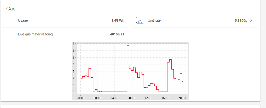

You probably already know this, but just in case: bear in mind that in the UK, most (all?) gas smart meters are battery powered, and only send a reading via your mains-powered electricity meter every 30 minutes. This is true even with the Octopus Mini: the Mini itself will upload gas data every 10 seconds or so, but it’ll be the same meter reading for 30 minutes. Thus ditto for the data downloaded from the Kraken API - it only has a resolution of 30 minutes (for gas), as evidenced in the graph!
