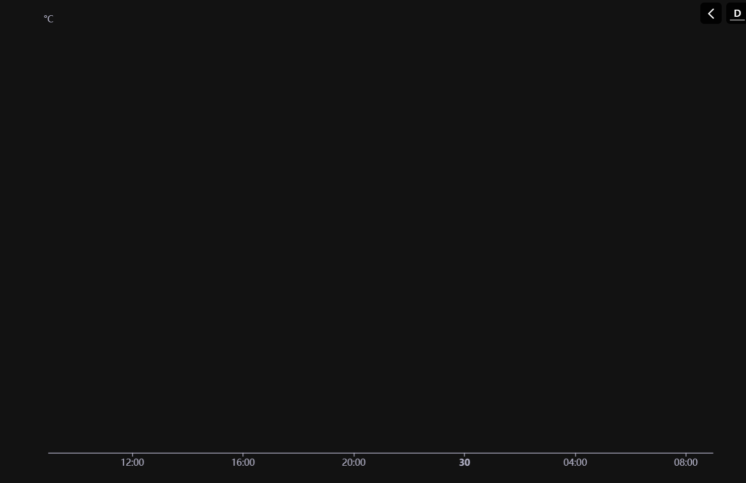

I would like to use the Docker based setup from now on. So far I have used an Openhabian based setup within a Proxmox LXC. I fail to migrate historical item values. All charts stay empty. They even stay empty when OH5 is running for couple of minutes and should have collected new values:

All files within /opt/openhab belong to openhab:openhabon the new system and the user openhab has UID/GID 999/995. The items and things appear and instantly everything seems to work. I can control lights etc. with the new system. It is only the missing historical values which is bothering me. Any hints?
