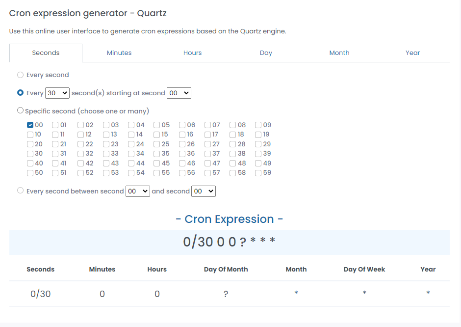

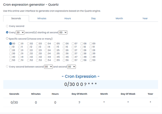

I did try that with:
Strategies {
every30Seconds : "0/30 0 0 ? * * *"
everyMinute : "0 * * * * ?"
everyHour : "0 0 * * * ?"
everyDay : "0 0 0 * * ?"
default = everyMinute,everyChange,restoreOnStartup
Items {
Persistence_Group* : strategy=everyMinute,everyChange,restoreOnStartup
Shelly_UNI_Persist_1Min_Voltage_ADC	: strategy=every30Seconds,restoreOnStartup
Persistence_Group_MAPDB*	: strategy = everyChange, restoreOnStartup
In this case nothing gets persisted. Further googling seemed to indicate that the minimum is every minute?
I will have to look at you further suggestions in more detail - but I am starting to suspect that this may beyond my current abilities.
EDIT: No errors when loading the influxdb.persist file, but nothing gets persisted. If I change back to everyMinute I see results.
Comparing the two entries
it looks like every30Seconds is not correct.
While every30Seconds has 7 entries everyMinute has 6 entries.
Besides that only minute 0 and hour 0 would be trigger every 30 seconds.
Try
every30Seconds : "0/30 * * * * ?"
