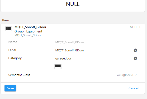

when I generate an eq from a thing selecting the the semantic class (eg. Lightbulb) than I get a Group Item with semantic class Equipment however tads Equipment and Lightbulb also added.
if I generate the eq in expert mode and in the definition of Group Item I replace the two [“Equipment”,“Lightbulb”] by [“Equipment_Lightbulb”] than I get the Item in the proper eq category. in the rest api I see the semantic class is Equipment_Lightbulb
the trick in 2. does not work with some eq categories (eg Gate)

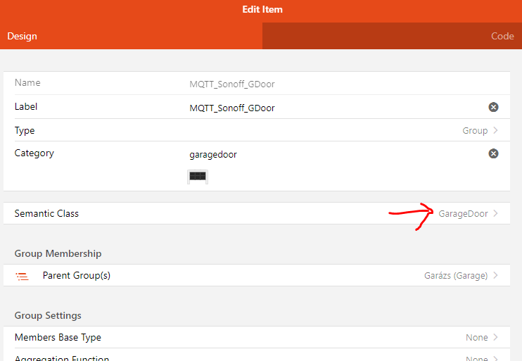

I am not able to change the eq category in the semantic class of the group item through UI. it accpts but change only the tags
I was not able to change the semantic class in the rest api (eg from “Equipment” to “Equipment_Lightbulb”
Can you please advise how to fix it. Many of my eq are under the Equipment block.
