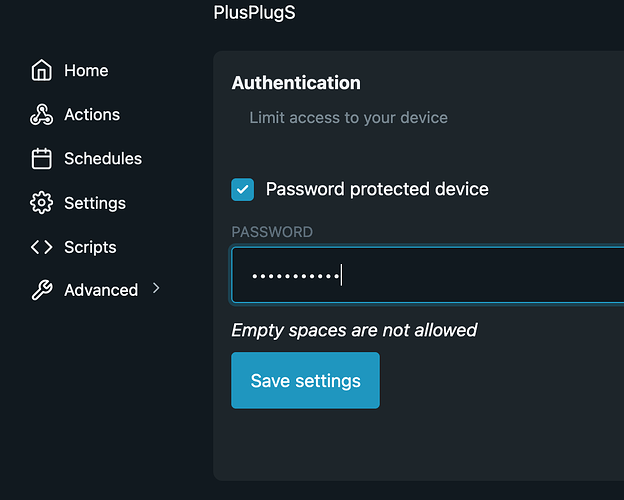

I’m using Shelly devices with openHAB 4.0.4 successfully for a long time and every device is protected by a username and password. Yesterday I installed the “new” Shelly PlusPlugS and activated the “protection” which requires only a password.
The openHAB binding also detects that only a password is required and doesn’t ask for a username. So far, so good.
Unfortunately after setting the password the configured thing reports a “CONFIGURATION_ERROR” (Access denied. Check username and password).
