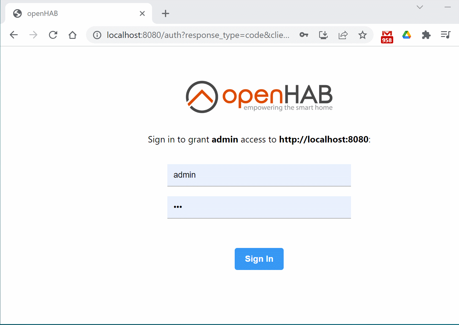

using latest snaphosts for openhab-addons and openhab-distro in Eclipse IDE.
When I try to login to localhost:8080 login fails like in animation below.
On logs I read:
16:57:51.504 INFO [OH-ruleengine-1 ] [mation.internal.RuleEngineImpl:1446 ] - Rule engine started. 19:05:29.851 WARN [qtp1918770618-224 ] [st.auth.internal.TokenResource:325 ] - PKCE verification failed 19:05:29.854 WARN [qtp1918770618-224 ] [st.auth.internal.TokenResource:135 ] - Token issuing failed: invalid_grant
I already tried to delete files in runtime/userdata/jsondb and re-created admin user, but nothing changed.
Any idea?
