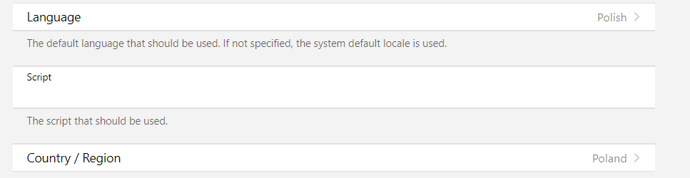

It should already be giving you the localized name for Thursday. Have you set your language in the Regional Settings?
If so, what’s the language set for your operating system running OH?

@rlkoshak the language of OH is correct (Polish)
(browser in in English)
