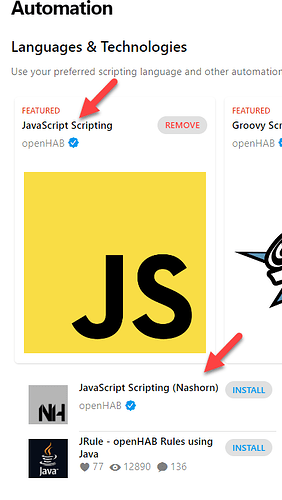

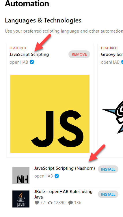

You need to install the JS Scripting add-on to use JS in a Script transformation.
Of course it is. (See below). I have the ‘featured’ language installed, rather than the ‘Nashorn’ (which is I think deprecated). The problem is evidently a timing issue since OH is apparently trying to use JS to transform values before the feature has installed. Once the ‘Rule Engine started’ has been logged (when presumably JS has indeed finally be loaded) then the errors go away. i.e. the errors only appear in the interval between system start and ‘Rule Engine started’.
