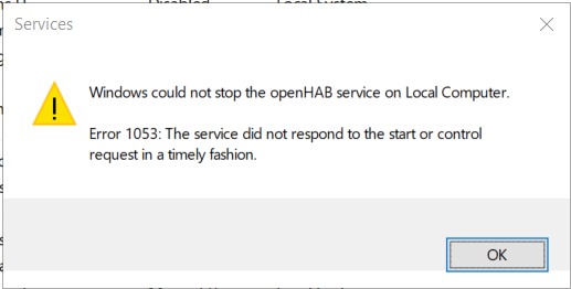

Either when running as a service, or from start.bat, when trying to shut down openHAB the processes just carry on running i a limited way and requires a reboot to recover.
The service eventually give an error:

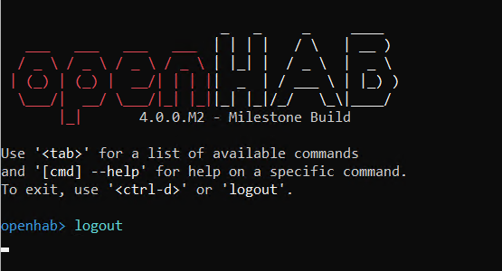

Using start.bat gives:
So nothing after logout until batch file terminated
