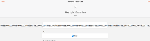

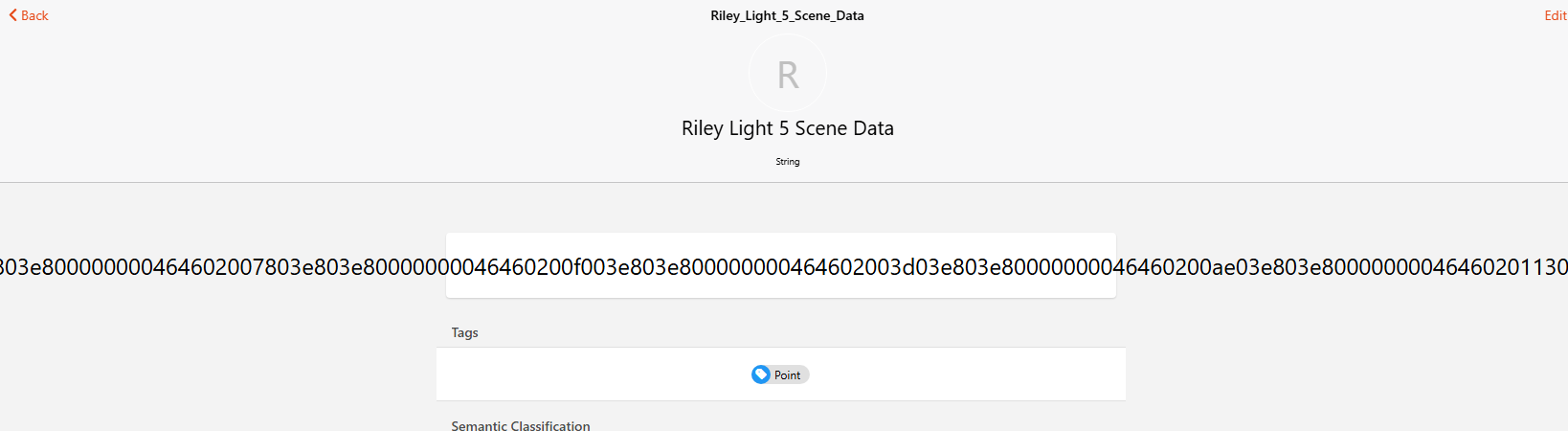

I have setup multiple scenes in the APP and when I look at the “Scene Data” channel ITEM, I can see the scene:
However I do not see a way to change the scene.

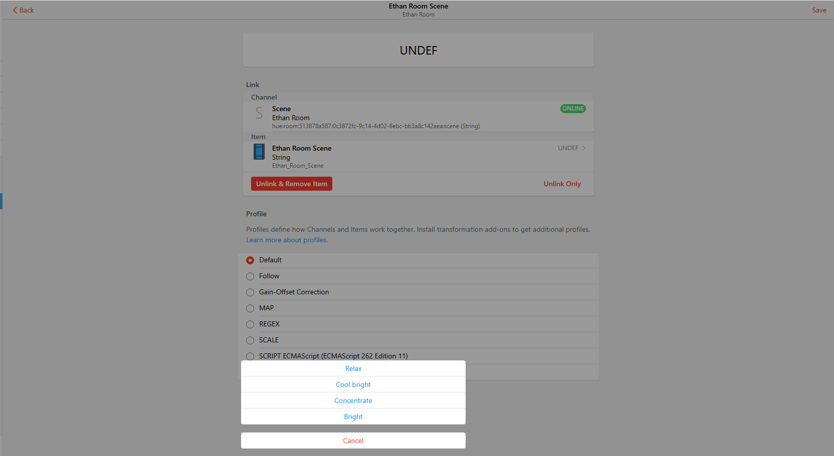

With the Hue setup you can click on the State and you get a list of available scenes.
The Scene names are also populated - so not just a string of numbers.
