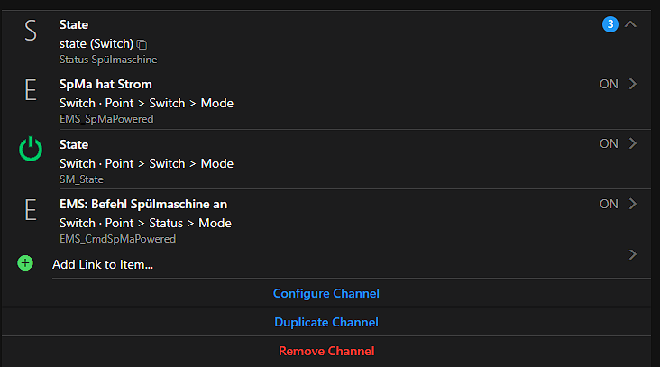

          stateTopic: devices/NousWaMa/betriebsart
all three items from the log is “standard”-linked to the power-channel
none of the “power”-items have any Metadata or a rule attached to them, which would cause this loop?
How is it started anyways? and what did I do wrong?
take out postCommand or set it to false
