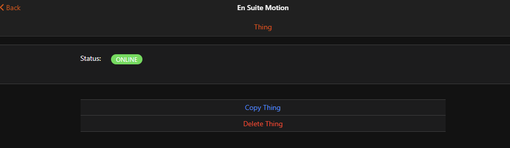

The problem is, none of the things have any details, it just show up blank, example non-MQTT thing:
I’ve spent the last hour or more searching posts, and can’t find anything that helps. :frowning:

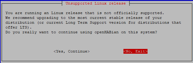

openhabian-config gives me the following warning, which is odd as openhabian was used for the upgrade:
openHABian Configuration Tool — [openHAB]{2026-09-21T20:08:56+02:00}(167a271d)
openHAB 5.2.3 - Release Build
