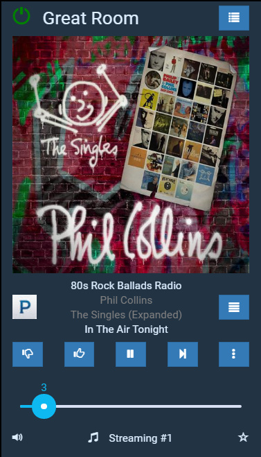

BTW - main window screen shot below of one of the zones that’s set to streaming pandora. Have about 10 screen built so far (am/fm tuner screen, selecting of sources, management of favorites, management of presets, etc). About to create the ‘dynamic’ screens (russound has media management where we can create dynamic screens to manage the various sources).
