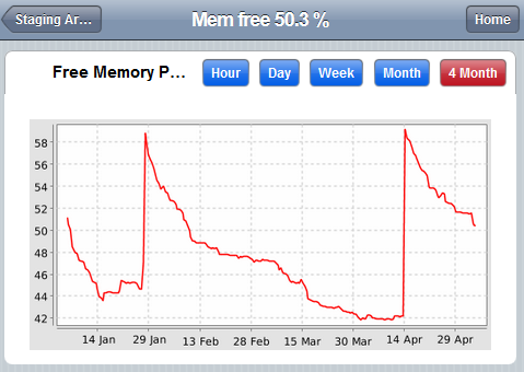

[peaks in the graph reflect the required reboots]
01/01/2019 Started OHv2
28/01/2019 stopped working
14/04/2019 stopped working
Both time, the system was running all by itself; meaning no console, SSH, update, config activity of sort. I cannot find any hits in syslog, OH logs as to why the OH died.
Is there a way I can monitor OH (other than through OH) to send a message somewhere to have the system rebooted?

Thanks for the other post… since my system is a production system, it would “disturb” a lot of things we rely on to be working… and removing any binding would fail the whole system, as rules (though in separate files for separate functionality) have a lot interdependencies. E.g. one sensor might be an input for many other things (ambient light, battery state of charge, other things setting proxy switches).
To monitor your system over a long time you should use Telegraf as a monitoring tool, InfluxDB to store the data and Grafana to visualize all the stuff. Telegraf is based on plugins and there is a plugin called “procstat” which allows monitoring specific processes like Java or OH. Please do not run InfluxDB on your Pi because of the heavy I/O for your SD-Card (I/O isn’t really heavy but your SD-Card won’t survive this for long time :laughing:).
The peak of memory usage in your graph is pretty interesting but not really critically for the system. With a look to my own monitoring data I guess a memory usage of 60-70% is pretty usual for a Pi3.
Of course you don’t want to read something like this, but you should question yourself what would be easier: To find the root cause for the memory peak which leads to the faulty OH or to do a clean install of OH2?
I will update my post to indicate these are the dates the system died, and reflects the memory free after a reboot.
As for the Pi, it has a 250GB SSD connected to it :slight_smile: so no SD card issues. (In fact all my rPis have an SSD attached to it.
Ah, your graph also shows the free memory and not the memory in usage. So the peak of memory in usage grows over several weeks. There are one or more processes which do evil stuff and leads OH2 to freeze. But it will be hard to find such processes because of this long term. It’s a classical race condition. So you should follow @matt1’s advice: Run OH in a kind of “safe mode” which means disable everything (rules, bindings, etc.) and enable them one by one while looking at the memory consumption.
