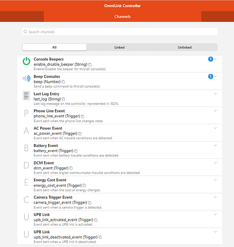

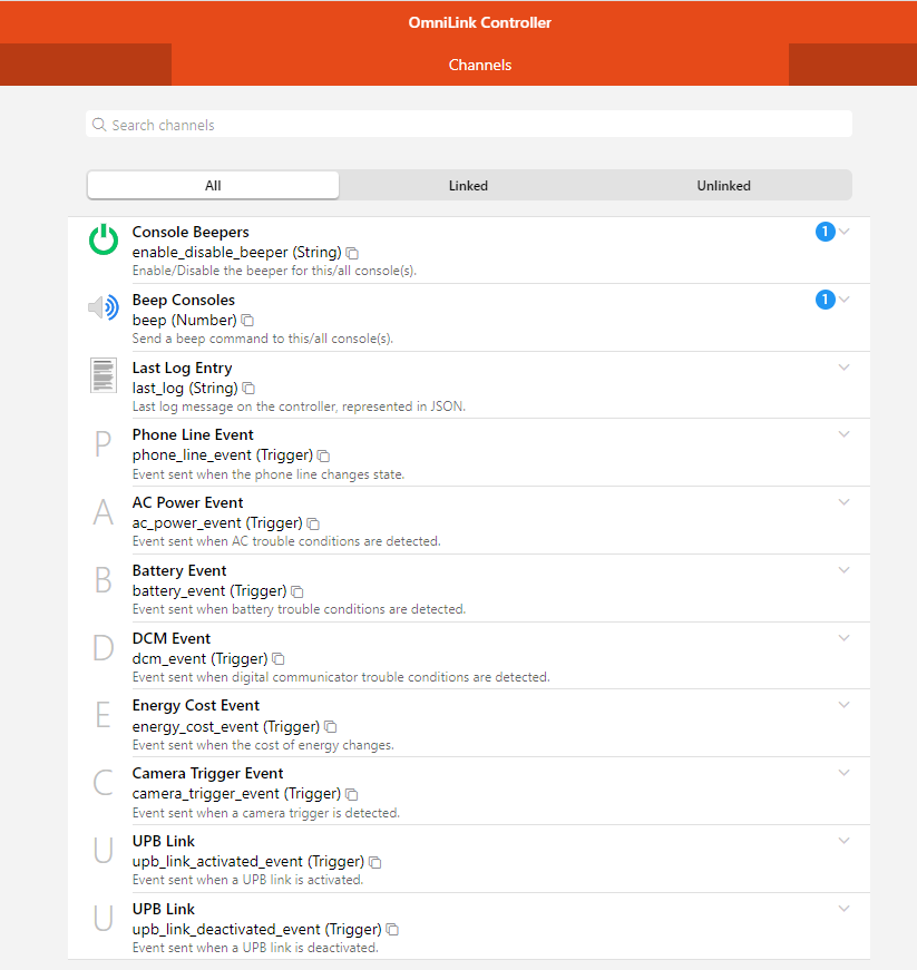

The screenshot is of my controller thing channels:
@ecdye correct me if I’m wrong, but I believe this was fixed post M2 release and should be fixed in the latest snap shot.
I just installed last nights snapshot for the binding. Still no system_date channel
Because the channel was changed users will have to delete their omnipro bridge thing and re-add it. It should automatically pick up all of your things linked to the bridge after re-adding it so nothing should be lost.

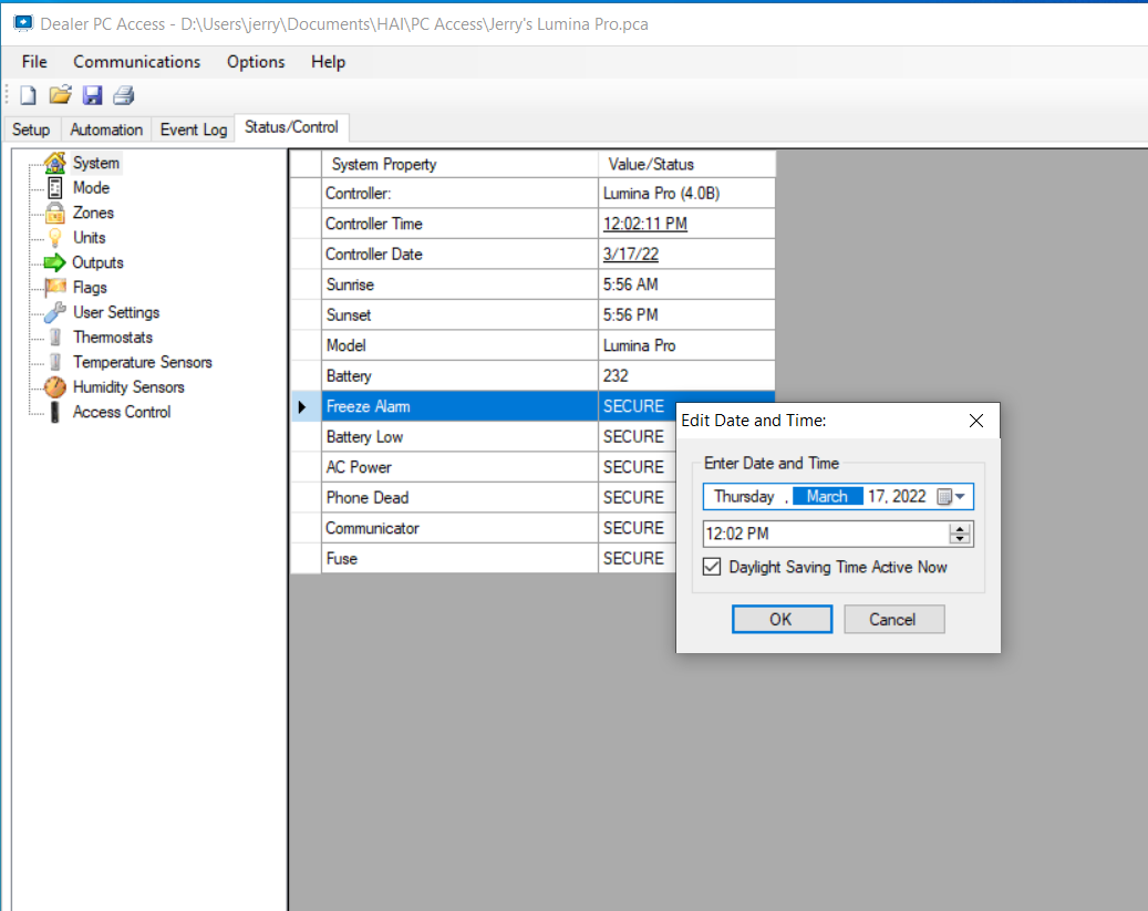

Here is a screenshot of PC Access before I trigger the sendCommand - Notice Sunrise and Sunset are 6:56AM and 6:56PM
Here is a screenshot of PC Access after I trigger the SendCommand – Sunrise and Sunset go back to 5:56AM and 5:56PM while the time is correct.
The way I fix it, is by toggling the controller time with the DST flag
I hope this makes sense.
