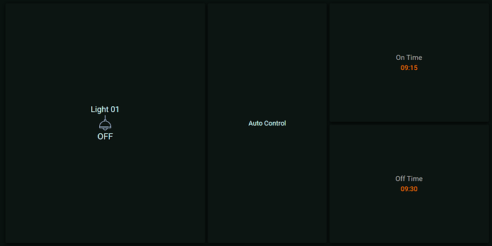

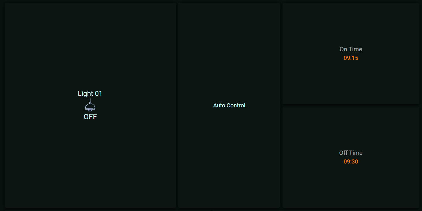

My idea was that the status of hours and minutes from item would be set, substituted in Blockly, and then if the set trigger corresponds to the current time, it works.
Accordingly, you can set any time, the rule will work, and the device will switch to the On/Off state.
I need to change the on/off time depending on the tasks on the fly, for example in a mobile HABPanel.
