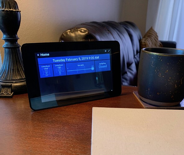

Here’s the setup so far (having problems with weather widget):

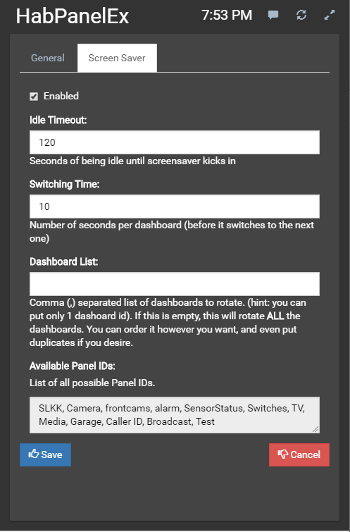

One thing I would like to do is install a screen saver that does a slideshow of photos. I can get a slideshow and I can get a screen saver but I haven’t found one that does both yet. Any suggestions?
Check the gallery and search the forums. I think someone posted some code to enable a screensaver in HABPanel.
Or a screensaver that activates a HabPanel panel that has an image slideshow?
Wink wink :slight_smile:
You know, I never thought of a HABPanel extension that would do that. It just never occurred to me. I will take a look. Thank you!
Wow. Did I ask the right person or what?!? Thanks. :grinning:
:slight_smile: haha
Hey Lucky, is there a setting so that when you interrupt it, it takes you back to a specific dashboard? Right now when I stop the slideshow I’m looking at that dashboard and I’d rather go back to my main one.
I feel like I missed a setting or something.
