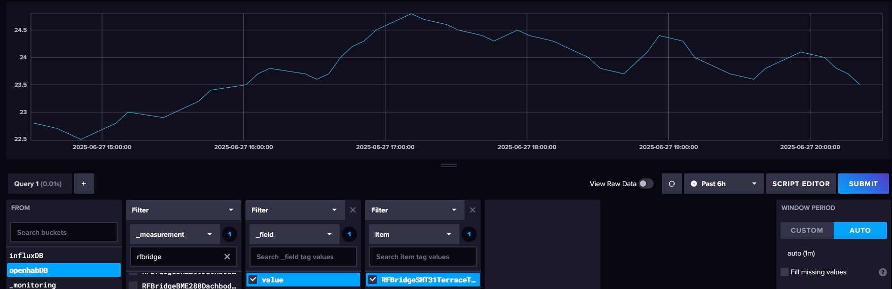

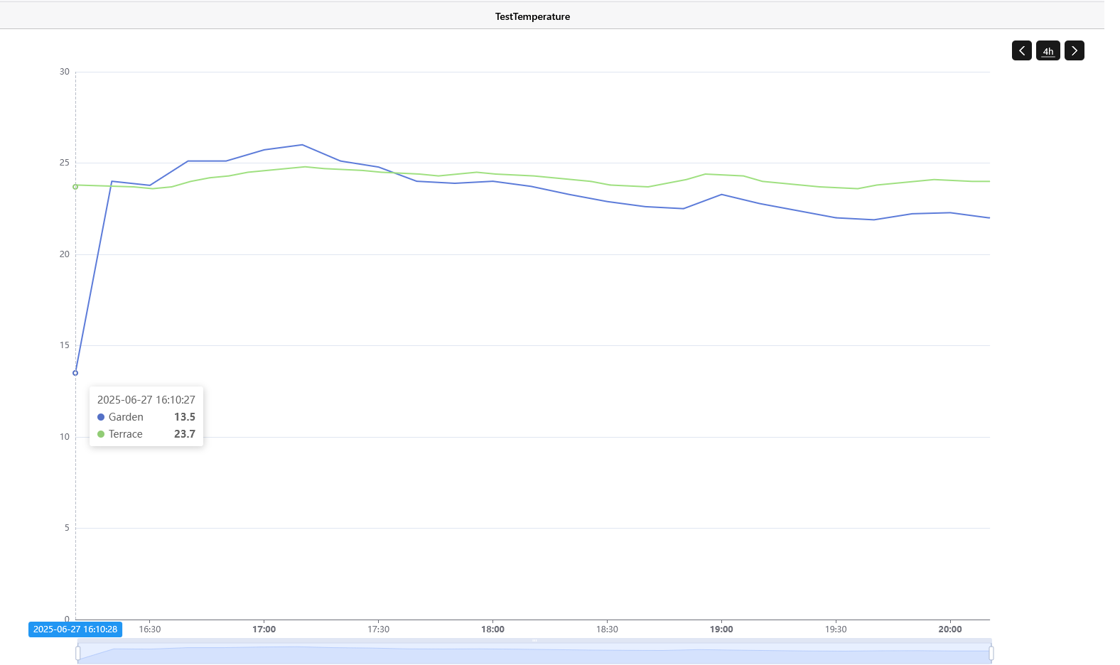

I have a cart page that displays different Temperatures around Home.
Unfortunately, the first value of a specific item is wrong.
I’m logging my item with InfluxDB2 (InfluxDB v2.7.6) in a container on a NAS.
So far, I can see only ONE Item that has this issue, all other Items are displayed correct.
The Item name is RFBridgeSHT31TerraceTemperature

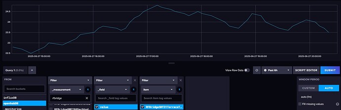

The value itself is correct in the database when I use the build in Data Explorer.
Changing the Chart period does not make a difference. The first value stays wrong and in fact at 13.5°C at every period.
I cleaned the cache of openHAB sudo openhab-cli clean-cache
I installed the latest improvement with openhabian.
I restarted the InfluxDB instance.
I’m not 100% sure but I think that Chart was correct at earlier openHAB version like 4.1…
My smartphone shows the same wrong value at the beginning and cleaning the browser cache does not help either.
Chart Page configuration
label: TestTemperature
sidebar: true
period: 4h
grid:
- component: oh-chart-grid
config: {}
series:
- component: oh-time-series
gridIndex: 0
item: WeatherStation_Aussentemperatur
service: influxdb
type: line
xAxisIndex: 0
yAxisIndex: 0
gridIndex: 0
item: RFBridgeSHT31TerraceTemperature
service: influxdb
type: line
xAxisIndex: 0
yAxisIndex: 0
xAxis:
- component: oh-time-axis
gridIndex: 0
yAxis:
- component: oh-value-axis
gridIndex: 0
dataZoom:
- component: oh-chart-datazoom
show: true
type: slider
orient: horizontal
tooltip:
- component: oh-chart-tooltip
show: true
orient: vertical
confine: true
