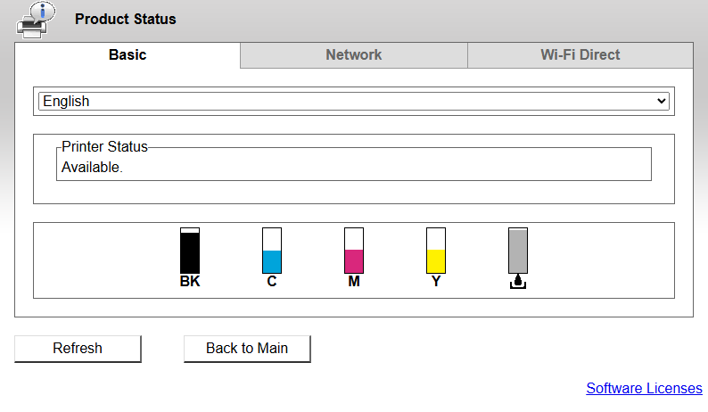

This might be the most redundant integration as you can just look at the ink levels in the semi opaque wells on the front of the printer, but there is a waste ink well (usually called a maintenance box) that will make the printer cease printing if it is full. The maintenance box level is visible through the UI on the printer, or at the web interface. My model is the ET-3760 (might be a made for Costco model), but if your web interface at:
http://your_printer_ip/PRESENTATION/HTML/TOP/PRTINFO.HTML
looks like this:
this method should work for you.
Using the HTTP binding, this is what my thing looks like:
