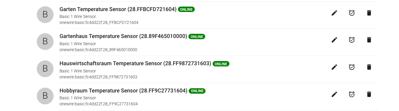

  • onewire binding and all 6 sensors (DS18b20) are configured via discovery in PaperUI as recommended
  • because of that I don’t have a dedicated things file - as I understand the onewire binding documentation it is not required (?)
  • under things listing all sensors and owserver are online
