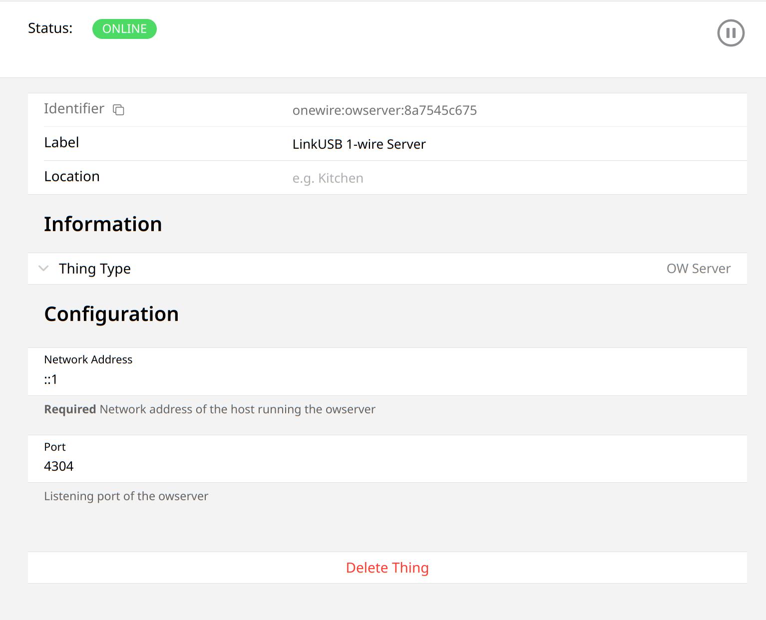

The Onewire bridge binding is installed as a ‘Thing’.
Network Address: localhost
Port: 4304
and if I ‘save’ this it shows Status: OFFLINE (in red), COMMUNICATION_ERROR
but if I configure it for the remote owserver
Network Address: control
Port: 4304
(and save) then is shows Status: ONLINE (in green)
Eventually I worked out that I can get the local one into ‘ONLINE’ state by specifying ‘::1’ instead of localhost. (So why does ‘localhost’ work on the command-line with owdir and owread but not in openhab? Is that a bug?)

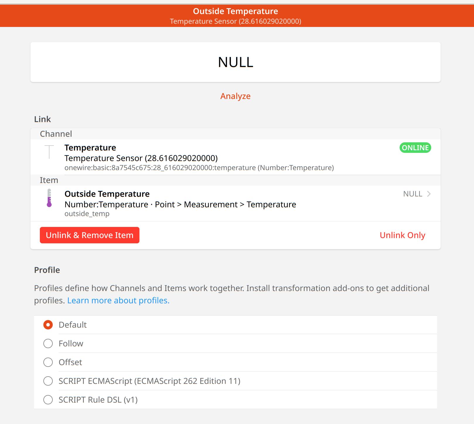

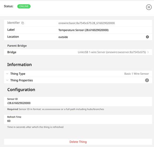

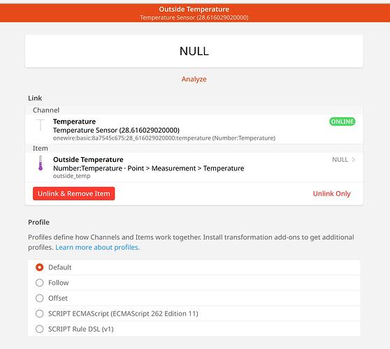

The problem is that I cannot work out how to get it to show me the actual devices or their readings. Once it’s working like this shouldn’t there be a list of device-ids that I could add as ‘Items’. What should I click on to get the bus enumerated. Do I have to do that externally myself and manually add the sensors (if so how?)
Also the openhab log is showing:
[WARN ] [.core.thing.binding.BaseThingHandler] - Handler OwserverBridgeHandler tried updating the thing status although the handler was already disposed.
4 times/second whether the status is shown as ‘ONLINE’ or ‘OFFLINE’. The log is rapidly becoming huge. Is that message significant?
I’ve tried looking in forum for old questions, but most of them are from 4 or 5 years ago and all talk about the old file-based config from openhab v1 2 or 3. Which doesn’t help much when one is using the UI-based config from openhab 4.
I’ve tried reading OneWire - Bindings | openHAB but again examples are in file-speak, not UI-speak. The file-config looks straightforward - I could put my IDs in there, but I don’t know how to do the equivalent in openhab’s UI.
I still haven’t really got my head around ‘Things’, ‘Items’, ‘Channels’, ‘Locations’ And how those map onto temp sensors.
Suggestions welcome on how to make some temp sensors appear (and get logged, and graphed).
