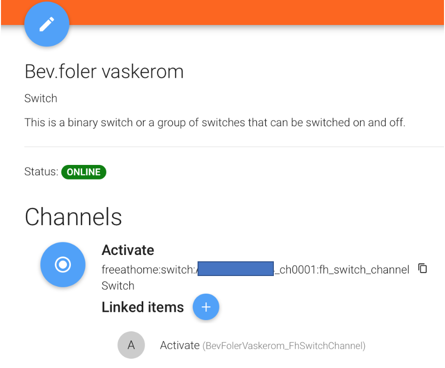

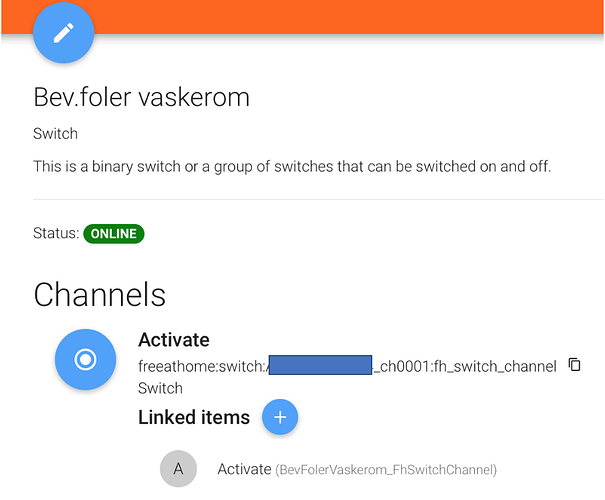

  1. PaperUI view of the Things / Channel / Item configuration
    45
  2. VS Code item (items/links were autogenerated in PaperUI using “simple mode”, then regenerated in the VS Code items.list using the OpenHab extension)
Switch   BevFolerVaskerom_FhSwitchChannel   "Activate" <motion> {channel="freeathome:switch:ABBXXXXXXXXX_ch0001:fh_switch_channel"}
And the hidden frame for (1) and the XXXXXXXXX for (2) is the serial number of the device which is confirmed to actually be the motion detector. As mentioned, the detector is not physically linked directly to the lights (I have the Free@Home setup with bus cable, and I am currently using the detector in event/action configuration within the F@H programming). However, the options are somewhat limited within F@H programming, so i want to use OpenHab to extend my possibilities.
How did you unlink and delete the Items when you moved from simple mode to .items files? Sometimes there are problems where the Link sticks around even when you delete the Item through PaperUI first.
The Item looks correct and the Thing is showing as Online. The Channel is also showing that it thinks it is linked to an Item.
