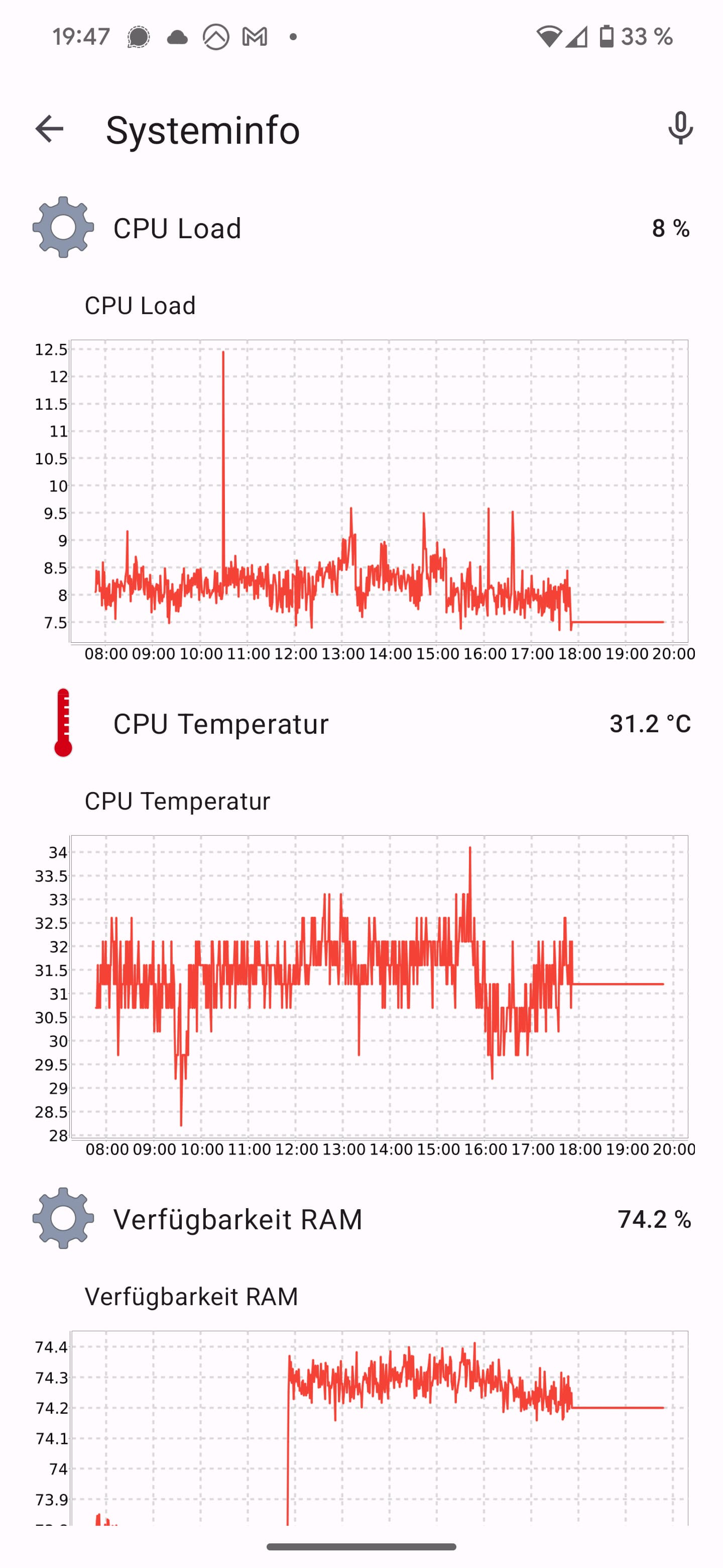

Symptoms are: Everything seems to work properly, the UI is reachable and i see things online. However, i can not send commands via sitemap i.e.
Another thing is, that values are not uptated anymore, as you can see in the pics below. Something happened at around 17:50 and the items are frozen on this state.
After a restart with “sudo systemctl restart openhab.service”, everything works fine again.
Sorry for another pic, i am on a different computer right now and am not able to reach my logs (only frontend). Here you see the log at around 18:00.
Sometimes it happens after 250h uptime, sometimes after 20. Please help me, this is too annoying :wink:
TY!

Is the “freeze” always related to the Miele web not responding? Perhaps an occasional network error is not managed correctly by some binding and causes some anomalous consumption of system resources.
I would look at the different memory channels of the system info binding to see if some of them show a steady increase prior to the problem. I have read somewhere that there was a problem with the number of threads being opened. There maybe a system info channel also for that.
Finally, have you tried with a different SD card? A failing SD gives unpredictable errors.

Hey, jea i do have a relatively beefy fan and even an UPS. Power supply is the official raspberry pi supply.
