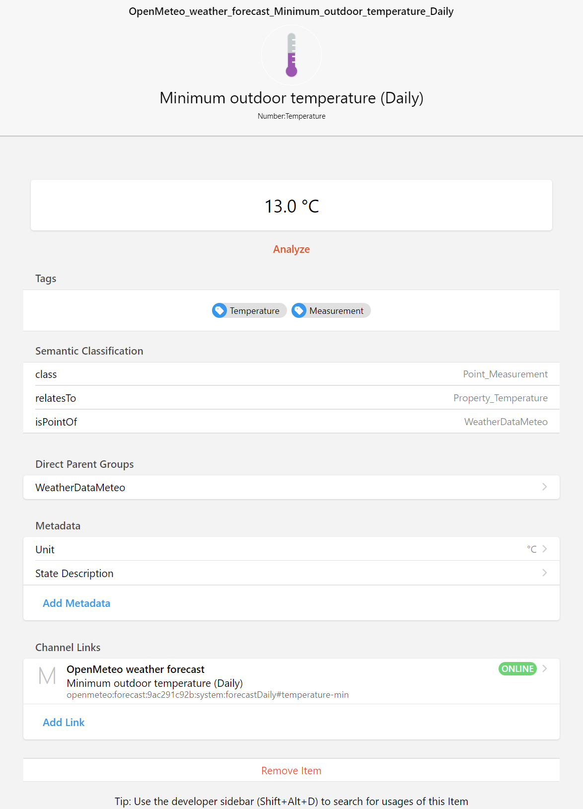

I have an item ‘OpenMeteo_weather_forecast_Minimum_outdoor_temperature_Daily’ and expected automatic new items
OpenMeteo_weather_forecast_Minimum_outdoor_temperature_Daily_Day1, OpenMeteo_weather_forecast_Minimum_outdoor_temperature_Daily_Day2…
I think I saw it for one item in the past…but I do not know to reproduce it…
Any Ideas? Thank you
I expected new items

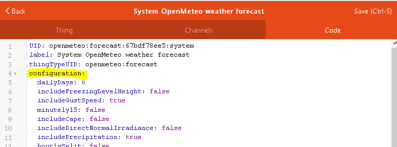

I suspect you have activated a combination of options that I had not thought of, but to confirm that, can you go into the configuration of the weather forecast thing?
Inside this, you have a “code” tab at the top, and it would help me understand the situation if you could send me the list of values below the configuration section:
Copying as text is actually better for me as there are quite a few values here.

One of the items
Thanks for the details. There is this in the configuration:
dailyTimeSeries: true
This means the thing will create a group for forecast channels using the persistence system to store future values.
There is also this:
dailySplit: false
which means creating one channel group per future day is disabled. If set to true, it will create a channel group per future day and was the only way to create future values in earlier versions of openHAB.
This explains the situation you described:
On top of that there is also this in the configuration:
includeTimeStamp: true
This is a relatively new option that indicates there should be a channel with the future time for which a forecast applies and this only makes sense in “split mode”. Considering you are not using this mode, you are totally safe to set it to false, via the associated toggle on the config page.
This should make the errors you see in the log disappear.
I’ll also investigate why these errors come to exist and will keep you posted.
thank you for the resposne, but I don’t have it yet.
I have the newest Version of open hub, I need Items for future values and want to use the “automatic” generation of time series items…
How should i configure it ?
Times series is a new concept introduced in OH4 which means you only have one channel that contains data for all future days: temperature_daily
In past versions, this was not available and so weather forecast bindings created one channel per future day: temperature_today, temperature_tomorrow, temperature_day2, … temperature_dayN
If you only want the “day1, day2” channels and link items to them, then you should do this:
dailyTimeSeries: false
dailySplit: true
And doing so, you won’t even get the issue that you discovered with dailyTimeSeries: true and includeTimeStamp: true
