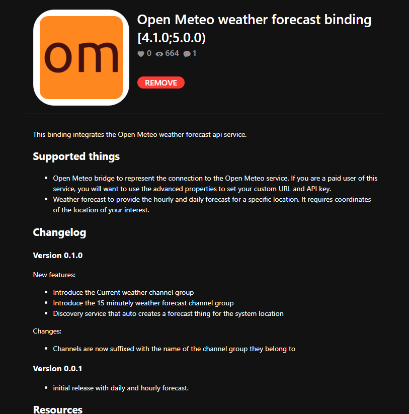

Version 0.1.0 is out with a current weather channel group, a 15 minutely weather forecast channel group
and a discovery service that auto creates a forecast thing for the system location.
Following recommendations for clarity in the MainUI, the channels are now suffixed with the name of the channel group they belong to.
