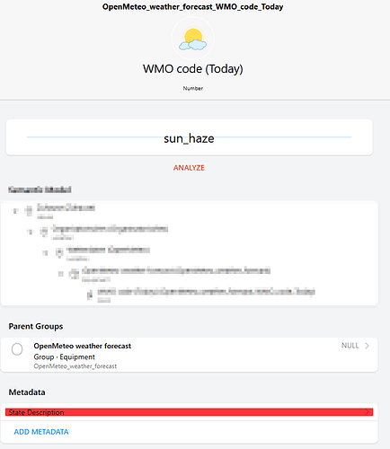

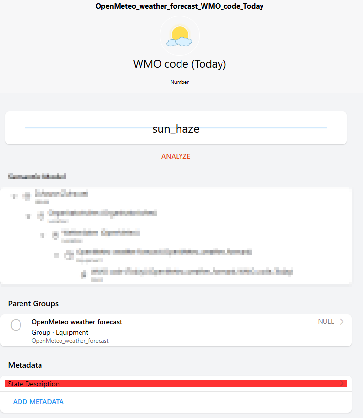

To display the correct icons the widget uses “WMO Codes” provided by the API.

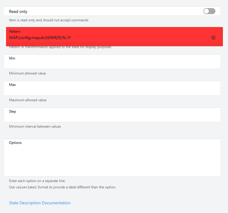

1.) Create a Transformation of type map via Settings->Transformations ( AddOn: "MAP transformation" is required) Use the content “OpenMeteo_wmoItem_stateDescription” source from GitHub
2.) Apply the transformation to all three items
OpenMeteo_weather_forecast_WMO_code_Today
OpenMeteo_weather_forecast_WMO_code_Tomorrow
OpenMeteo_weather_forecast_WMO_code_Day_2
Select the transformation you just created, but replace %s with %.1f
So pattern declaration ist: MAP(config:map:4c36f6ff29):%.1f
Once you are finished, the numeric code will be displayed with the corresponding icon name.

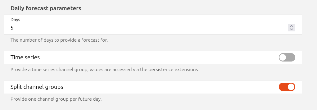

Hi, I just realized that you need to split the channel groups of the daily forecast parameters for them to appear with the correct names (_Today, _Tomorrow,…)
