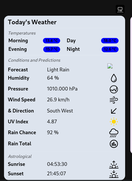

Open Weather API Day Widget
All of my (Kyle Mason) (mediatech15) widgets are free to copy modify and edit how you see fit. You may re-post the variants freely (an inspired by is nice)

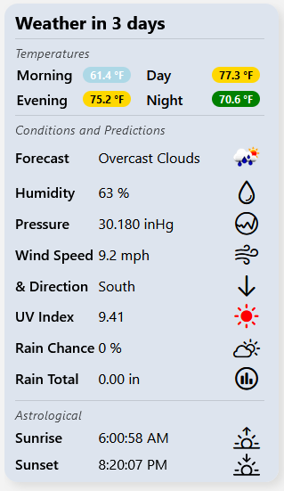

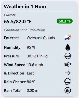

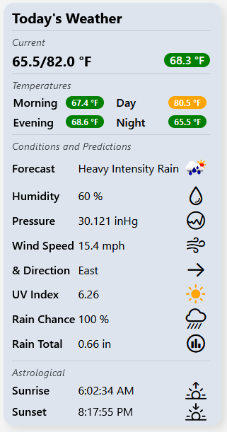

This widget is cell look alike widget for use with the OpenWeatherAPI One Call. This allows you to specify the root item and then based on a few parameters you can make dynamic cards.
  • Fully Responsive
  • Supports Day and Hour
  • Dynamic hiding of elements not supported by Time (Days vs Hours items)
Configuration is simple and straight forward.
Screenshots

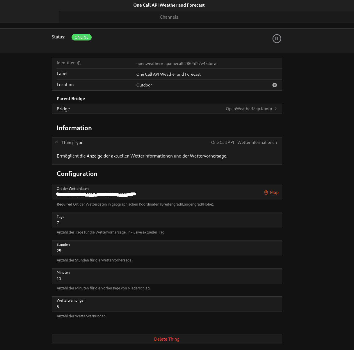

Hi, that’s a cool widget. Which Item do i have to use. I don’t find the item which is shown in your screenshot.
Are you using the one call api? The item is the root Onecall api item. That said if you renamed the thing the root item name will be different.

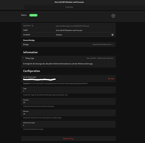

Here is my thing Configuration, should i find the item under the cannels?
I got the right item. I found it under the “model”. It’s the group item for “open weather map” thing.
Thank you

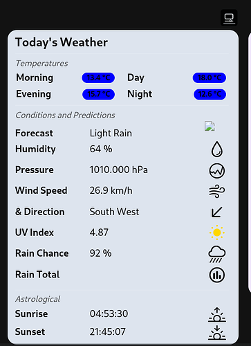

I will say that the current colors and all for temps are in F vs C but I can make an update or you can adjust in the widget config to your liking.

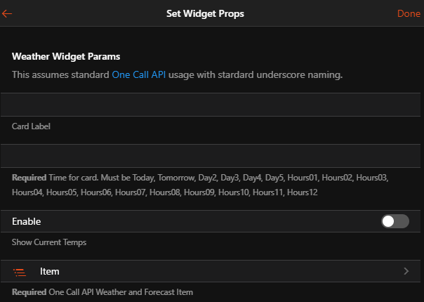

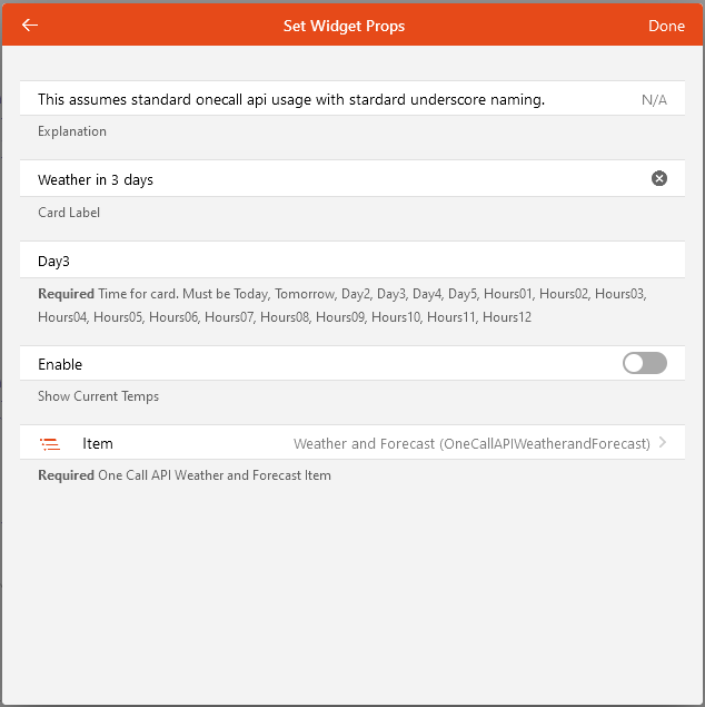

May I suggest this for the definition of your props:
props:
  parameters:
    - description: Card Label
      required: false
      type: TEXT
      groupName: weather_widget_params
    - description: Time for card. Must be Today, Tomorrow, Day2, Day3, Day4, Day5, Hours01, Hours02, Hours03, Hours04, Hours05, Hours06, Hours07, Hours08, Hours09, Hours10, Hours11, Hours12
      required: true
      type: TEXT
      pattern: Today|Tomorrow|Day2|Day3|Day4|Day5|Hours01|Hours02|Hours03|Hours04|Hours05|Hours06|Hours07|Hours08|Hours09|Hours10|Hours11|Hours12
    - context: item
      description: Show Current Temps
      label: Enable
      required: false
      type: BOOLEAN
    - context: item
      description: One Call API Weather and Forecast Item
      label: Item
      required: true
      type: TEXT
  parameterGroups:
  - name: weather_widget_params
    label: Weather Widget Params
    description: This assumes standard <a class="external text-color-blue" target="_blank" href="https://openweathermap.org/api/one-call-api">One Call API</a> usage with stardard underscore naming.
If you put all your parameters into a group you have a chance to give it a description (basic HTML is allowed) so your explanation would look way better:
Also remember to put only a single link to your raw code in your post and add the published tag so folks can install your widget from the openHAB UI.
Also this parameter which only accepts certain values could be defined like this:
    - description: Time for card. # Must be Today, Tomorrow, Day2, Day3, Day4, Day5, Hours01, Hours02, Hours03, Hours04, Hours05, Hours06, Hours07, Hours08, Hours09, Hours10, Hours11, Hours12
      label: Time for card
      required: true
      type: TEXT
      limitToOptions: true
      defaultValue: Today
      options:
        - label: Today
          value: Today
        - label: Tomorrow
          value: Tomorrow
        - label: Day 2
          value: Day2
        - label: Day 3
          value: Day3
        - label: Day 4
          value: Day4
        - label: Day 5
          value: Day5
        # etc.

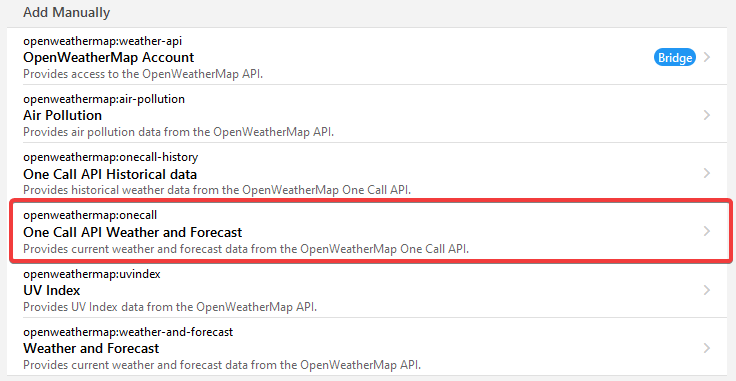

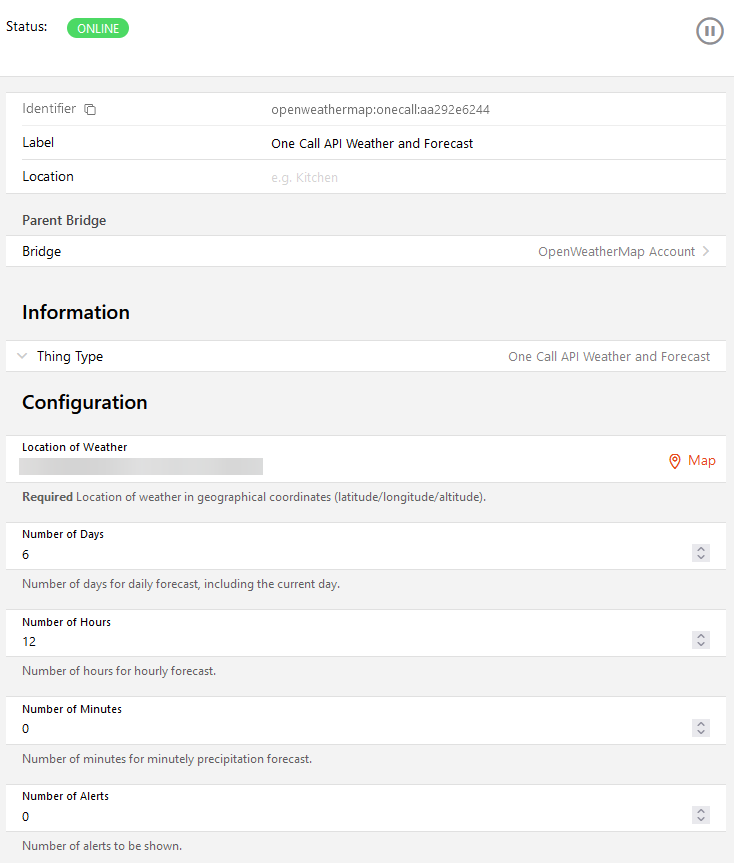

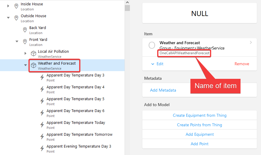

I’ve looked everywhere for this root item to no avail! There is nothing in my items list, and the channels for the onecall weather thing doesn’t contain anything that looks like what you describe. Can you point me in the right direction please?
After you have setup the OpenWeatherAccount Thing make sure you have added the thing below
Then once you have added that you should have something like this
Then in the channels There is a long list of everything the thing has. You need to add all the channels to items like normal. The key is
  • Don’t change default naming for items
  • Add all channels to items as the widget uses most (or a large majority) of them
Then you have them all added as items and they are all grouped under a single item like
![firefox_1PLG8h5DJq|356x499](upload://chWTfRi850epIif7cC2UIxuEm9j.pn
The Item the widget wants is the group
Let me know if this helps. Sorry for the delay.
As noted above this all assumes it is all done in English. There is a defect currently with it not working in other languages.
